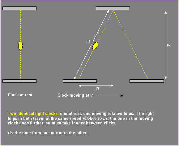

y = y' follows from the Lorentz transformation for time, i.e. ##t' = \gamma (t - vx/c^2)##. An observer in the stationary frame measures a distance y in the direction perpendicular to the direction of motion (of an observer in a rocket ship) by sending a light signal from the origin (0,0) to a mirror located at position (0,y) and measuring the time, t, that it takes to return to the point (0,0). It takes t = 2y/c. But the observer in the moving rocket frame sees that same light signal travel a longer path over a time t' = 2d/c, where d is the hypotenuse of a right angle triangle whose base is v(t'/2) and whose height is y'. This is because, in the moving frame, the light is emitted at time t'=0 at a point on the x' axis (-vt'/2,0), travels to a point (0,y') and returns to a point (vt'/2,0) at a time t'.
So let's compare y and y':
(1) ##y = ct/2##
(2) ##y' = \sqrt{d^2-(vt'/2)^2} = \sqrt{(ct'/2)^2 - (vt'/2)^2)} = (ct'/2)(\sqrt{1-v^2/c^2}) = (ct'/2)/\gamma##
Since x = 0, ##t' = \gamma t##. So substituting this for t' in (2) results in:
(3) ##y' = c(\gamma t)/2\gamma = ct/2 = y##

hmmm, I'm not so sure. there is an issue in the case of the light clock, which is time dilation being a result of the height remaining the same.
conversely, if we assumed that there was no time dilation then there would be a height contraction of the light clock.
The issue of time-dilation arises because one is invoking the principle of relativity with the light clock...
that the round-trip of the light signal in that light clock marks one tick for that clock, as it would for a clock at rest,
but that elapsed time measured by "the clock at rest" is different than that of "the clock at rest".
While one may be so unhappy with this time-dilation result that one tries to use height-contraction to avoid it,
the arguments above show that no such height-contraction exists (as in the Galilean case, which we already presumed)... since to do so violates the principle of relativity. [I guess one could have also questioned the principle of relativity... and be led to consider other implications... ultimately being tested by experiment.]
So, my point is that consideration of transverse contraction is an afterthought... since transverse-noncontraction is already practically presumed in the Galilean case.

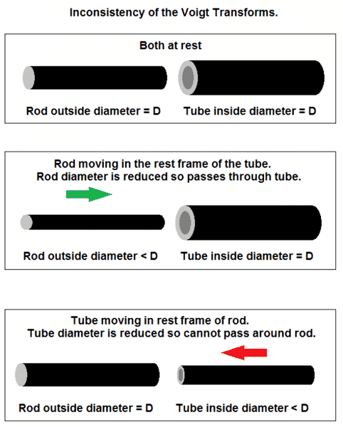

MikeLizzi said:
The sphere cannot make it through the hole. Paradox.
I've seen it as the "Rod and Tube Paradox". The Voigt Transforms suffer from this problem.
What does it look like when you draw a Minkowski-esque spacetime diagram and then transform it?
In SR the pole-barn paradox is averted when a Minkowski spacetime transformation reveals the RoS.
The biggest issue with the Voigt transformations is that the primed and un-primed equations are not reciprocal.
The biggest issue with the Voigt transformations is that they give the wrong answers, whereas the Lorentz transformations give the right answers. Voigt didn't know that, of course; but we do.

If y'=y/γ , then y=γy'
Then this wouldn't happen and there wouldn't be any collision paradoxes. But if y=γy', it would violate Einstein's first postulate.
