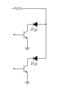

Hi,
will I damage the IC (it is 74LS07) if I select a pullup giving 20 mA of current trough the open collector (without any other load)?
I looked at the datasheet but I can't figure which parameter should I be looking at (because they give HIGH-level output current of 250 micro amps. What I "inject" trough the open collector is -20 mA as far as I understand it, so it kind of confuses me)
Here is what I want to do:
http://prikachi.com/files/1299347N.png
(Sorry for the poor drawing)
Not only do I use the transistors to use the bigger current, but I also use it as an invertor.
If I have a zero, the 20 mA go trought the respective LED. Otherwise, they go to GND trought the IC.
Will this work?
Thanks in advance :)

Welcome to the PF. I broke your question off as a separate thread, since the one you posted on the end of was pretty much done 6 months ago.
Look at the Vol spec in the datashet (output low voltage at current). That will tell what output low voltage you can expect at different output (sink) current levels.

Thank you for your welcome and for answering. I just attached a drawing to my post.
I can not really understand that with the output voltage. Isn't the very idea of open collector ICs that I can use whatever voltage I want to? And I was really asking for the current. These specs sound to me not very different from those of the regular circuit (without the transistors at the outputs). I only wanted to use this circuit so that I could have enough current to drive the LEDs.
Before someone suggests the easy way out - I did draw the other end of the LEDs going to GND, but only to keep the drawing simple. I can not drive them with zeros and constant pluses, because the LEDs are actually connected between two ouputs of two TTL ICs. That is, to have a LED turned on I would need to have TRUE (logic one) to the first output, and FALSE (logic zero) to the second.
Sorry, it is my first time I am using such circuits.
I am not sure I understand what you want to do. If both collectors ar open, both LEDs will light, but share the current from the 22-ohm resistor. If EITHER or BOTH collectors are saturated, NEITHER LED will light. Is this what you want?
Usually TTL open collector buffers are reasonably good current sinks. The 74LS07 hex buffer is rated at ~40 mA (Texas Instruments data sheet).

Thank you, Bob! That was exactly what my question was.
What confused me was that these 40 mA were specified as Low-Level output current. Since the Collector-Emitter circuit is open when the transistor is saturated (at High-level to its base) and consecutively it is then when the current goes trough it, I though it is the other way round - that I should be looking at the High-Level output current. Would you explain, please.
And another question - Actually, I wanted only one LEDs to shine, the one which is in cutoff. But now when I think about it, the other (saturated) transistor will drain all the current to its GND, so I will have neither of them glowing. Can you suggest how to fix this?

The circuit that you subsequently added to your original post (OP) is incorrect.
The cathodes of the LEDs should each go to a collector of the open collector outputs, not to ground. Each LED should have its own current-limiting resistor connected between the power supply and the LED anode, and each LED anode should go to an open collector output to sink current when the transistor is on.
I'm not certain what it is you are trying to do, but why not try using the ground through the IC to complete the circuit, like this

The VOL (output low) LS07 maximum output current should be specified as -40 mA because the saturated collector is a current sink. You have two choices.
1) Use a separate series pullup 150-ohm resistor (minimum) tied to 5 volts and to both the LS07 open collector and to the LED anode in parallel (with LED cathode tied to ground). (I personally don't like this).
2) A separate series 100-ohm (minimum) pullup resistor tied to 5 volts and to LED anode. The series LED cathode is tied to the LS07 open collector. (This is inverted logic - Collector low = LED ON).
See above. Use separate pullup resistors.

Here is more detailed drawing of my device:
http://prikachi.com/files/1301415F.png
The idea is following:
Let's say we want to have the second LED to shine. We put 10 to both decoders, which will make the second output LOW and all other HIGH.
So far, I have ground only to the second LED. But I also have one on its anode.
At this point, I could have used just simple inverter after the left decoder, but I didn't because the output current of it (~0.8mA) is far too little to make the LED shine. So I need open collector.
I do not use open collector inverter, but a buffer, because of the way I wire it - it becomes inverter.
Now the "10" from the left decoder saturates the upper transistor and gets into cutoff the middle one, which causes the circuit to complete trough the LED (inverted).
So the second variant proposed by you, Simon T. and I believe it was what berkeman meant doesn't work for me. Because I switch the ground too.
If you are wondering why,it is because I am actually driving a LED Matrix display.
Now, I didn't really understood your first proposal.
And to finish, I'll give the problem in a nutshell.
Only one transistor will be in cutoff at the same time. So the current will go trough every other transistor to GND. And because there are eight of them it is like having 7 150ohms resistors connected to ground in parallel:

You don't need two decoders, you only need one. And you don't ground out the pullup resistor to turn off the LED, you ground out the cathode of the LED (with a resistor feeding its anode from the power supply) to turn it ON, and you turn off the output transistor to turn the LED off.
I'm not sure where you got this idea of how to drive LEDs, but it's plain wrong. It's wasteful of power, which is a bad design error. Please look at the way we are telling you that LEDs are driven.
Could you give more details of what you are trying to do? Drive how many LEDs? Using how many outputs from the PIC?

When driving an LED matrix like that, you need to time-multiplex the drive signals. You energize a row by driving an anode row line high, and you ground out the appropriate cathodes with your open collector drivers for whatever LEDs in that row you want to appear ON. You then move to the next row and do the same thing. You rotate through the 8 rows at a rate above the "flicker fusion frequency" of the human eye, say at a couple hundred Hz per 8 rows of refresh.
You will have a series current limiting resistor for each of the 8 columns as you go from the cathodes into your open collector drivers. All the current being driven goes into making light, and none is wasted bypassing the ddrive to the LEDs (as it appears to be in your scheme).
EDIT -- note that your row drivers have to be pretty beefy, since a single one may have to supply the current for 8 LEDs.
Mishob-
Thanks for finally explaining what you are doing. Your 8 x 8 LED matrix is very similar to the PROM (programmable read only memories) matrix we used to use. The PROM memory was "burned" in by simultaneously pulling up on an x line and down on a y line, and melting fuse links where the two lines crossed.
You have two 3-line-to-8-line decoders, one for x and one for y. Each decoder is one-of-eight active (active low?). One driver (the pullup) has to be active high, so if you are using the same decoders for x and y, you will need 8 inverters. You will be pulling up only one x line and down only one y line, so only one LED will be lit at any given time.

This is exactly how I initially planned it. But it turned out my 8 inverters weren't powerful enough to make the LED glow, so I decided to use open collector circuit.
But I use buffers, instead of inverters, because the way I connect it, it works as inverter.Thank you, guys, really, thank you, for keeping replying. I really do understand your point with the anode to 5V and cathode to collector, but I just can't see how it is applicable in my case.
If you run the LEDs at a target 10mA each, that means that the anode drive buffer gates need to be able to source 80mA each. That's more than any logic family that I know of, so you would need to parallel up several buffer gates per anode line. You could use 4 x 74ACT244 type gates in parallel to be able to drive 80mA:
javascript:eek:penreq('http://www.datasheetcatalog.org/datasheet/fairchild/74AC244.pdf')
So to drive all 8 anode lines, it will take 32 buffer gates, which fit in 4 IC packages.

Hi Berkemen. For his particular application only one row and one column can be selected at any time so this (driving 8 at a time) won't happen. He only needs to design for one LED load, approx 15 mA, sink for the coumn decoder and source for the row decoder.

Yeah I know, but he's got an active high decoder output driving the rows (anodes) and an active low decoder output driving the columns (cathodes), so it's definitely only one LED at a time. :)

I suspect you were trying to use one of the TTL families (74, 74LS etc) for the inverter mishobg. TTL families have very asymmetrical output characteristics and generally can't source nearly as much current as they can sink. CMOS families tend to have somewhat more symmetrical characteristics and so would make a better choice for the inverter (row drivers). Use and advanced CMOS part like 74AC04 for the inverter and problem solved ok. You can keep the resistor value at 150 ohms and you'll get approx 14mA, or you could go up to 220 ohms (and about 10mA) if you want to be more conservative of the device capabilities (recommended).
You are right it was 74LS04.
So all I do is replace the inverter. Wow! That really will save me a lot of work. And I really should start looking more into CMOS.
Thank you all very much.
PS: I'll go with 74HC instead, though. It is easier to find one. Datasheet says maximum output source is 25mA as compared to 50mA with 74AC, but it will do the job.

Yeah "HC" is cheaper and more readily available, but the high state voltage won't be as well defined as it would be if you used the "AC" part. I think you'll find that the "25mA" figure you quoted is an "absolute maximum" rating and under short circuit conditions. You really should look at the current under "V_OH" specifications which I seem to remember is more like about 5mA for HC parts.
I'm not saying that you won't be able to squeeze more than 5mA out of a 74HC04. I'm just saying that you may have to let the output voltage droop to some not too well defined level in order to get this current. This is a particular problem if you also need to drive other logic inputs from the same output that you're trying to squeeze more than V_OH rated current from, because you start losing noise margin. It's not such a big problem in your case but it will make the choice of resistor a bit more difficult and you may even end up with the case that the current is limited more by the inverter output then by the resistor. This is undesirable as the LED current could vary much more (from one build to the next and also with temperature) than it would if the logic output levels were better defined and the current value set more primarily by the resistor value.
