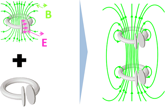

Wireless electricity transmission works by passing alternating current through one coil to which another coil corresponds and thus is coupled. At least this is the way WiTricity explains it. They also say that it's very much like mechanical resonance and that's why it's more efficient over greater distances than just ordinary induction.
What I don't get is how can two coils be coupled like that? Is there some eigenmagnetic frequency that every coil has which allows them to be coupled when the frequency of the magnetic field hits that eigenfrequency?

It just isn't straightforward - and, as you say, it isn't widely implemented. There are claims of all sorts fantastic performance but they don't seem to bear too much scrutiny. It seems that many of the ideas that Tesla originated are treated with undue reverence and some very romantic attitudes. His Patent is full of airy fairy and non specific notions and I couldn't find any actual numbers there.
There is coupling between any two conductors through space. The mutual coupling between coils can be optimised by tuning /matching but the efficiency drops rapidly with distance. Videos of 'working systems' seem to show equipment working remotely but with no actual Power measurements. I think there are a number of charlatans in the business as there is money burning holes in would-be investors pockets.
Sounds right to me.
Have you ever lived with a piano ?
If so you've heard its strings repeat sounds from the radio or a conversation in the room
each string responding to its particular "eigenfrequency" ( which term i just now learned, http://www.merriam-webster.com/dictionary/eigenfrequency )
The string is stimulated by all acoustic energy striking it
but of course only that energy at its resonant frequency adds cycle by cycle, building up in intensity.
Recall Q = (energy stored) / (energy dissipated per cycle)
A coil will respond similarly to electromagnetic energy striking it
and if its Q be >1 then energy at its natural frequency will accumulate
"Tuned RF Radios" use a variable capacitor to tune the antenna to desired station
But you'll never get out more energy than was put in,..So to me, yes it's very similar to mechanical resonance.
