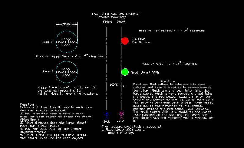

Click on attachment and post your answer:smile:
You'll be amazed!
Winner Willie
or
Red Balloon
Amazed that I responded to this thread. There doesn't appear to be enough information, such as the vertical distances, and the distance between large happy planet and the finish line.

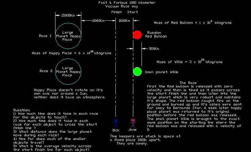

Hi Jeff
Sorry for the omission of data.
The distance from the start line to the happy planet is 3000 kilometers
Sorry about that.
Chuck
Still needed are the vertical distances between willie and balloon, as well as the vertical component of distance between happy planet, willie, and balloon. If I put willie 1 trillion km below happy planet and balloon, balloon will win the race everytime.

The idea is that there is only one happy planet and each race starts at a different time. But if it helps, you could think of the race happening simultaneously but far enough apart that the gravity from the objects from the upper race don't affect the objects in the lower race. A trillion km if you will.
I 'm attaching another JPG with the added dimensions.

While not completely giving away the answer, consider each race as a closed system, and note that being a closed system, with no external forces, the center of mass of each closed two body system will not move.

What I meant was that the center of mass between Happy Place and balloon doesn't move, and neither does the center of mass between Happy Place and Willie.
Gotcha ya. The center of mass will not move and in the case of the red balloon the center of mass won't be to far from the center of happy planet.
