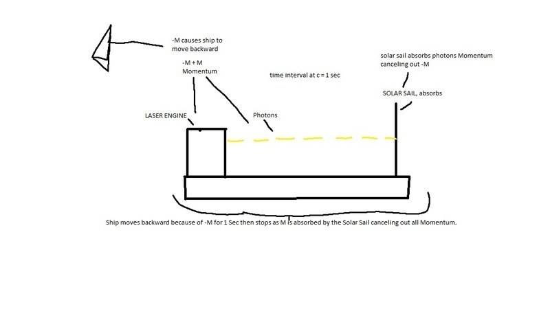

I drew a picture just so to make sure everyone knows what I am trying to visualize at least
Now what if the solar sail was just 100% efficient solar panel? Your ship moves and you get the energy back as long as the laser engine is 100% too, lol, something is wrong
Infinitum said:
I'm somewhat confused by this explanation. There can't be a net displacement with no external force acting on the light-boat system. My idea to this is, the photon cannot stay in the atom of the sail forever, it -has- to be emitted out, since atoms hate excited states.
What has happened is that some energy has moved from one end of the system to the other end - all internal and nothing external needed at all.
This would result in the boat moving back again to its original position. I'm not entirely sure of this though
Correct. If the energy moves back to the original end.
Yes. Moving the energy from the sail back to the engine moves the ship in the reverse direction.
Because the movement of the charges I assume? So with a solar panel there really would be no net movement. Without though, there would be a net movement if the laser was powered by say a nuclear reactor .
Assuming this is true...
Yes. You would get the energy back. To begin with, it didn't go anywhere if you consider the light-boat system. And the boat came back to its original position. No loss or gain of anything.
And if the solar sail was a reflector then the movement would be double that of the absorber correct?

I was just thinking and obviously the ship would move
absorbed case:
The photon emitted has momentum +1 and the engine and hence ship has momentum -1, since photon is not part of the ship, the ship moves back with -1 momentum. Now when photon is absorbed (case 2 next) the photon imparts +1 momentum causing the ship to stop. Thus ship moved but then stopped. ship has no momentum. Momentum Conserved.
absorbed case 2:same thing up until absorption
Photon is absorbed on sail imparting +1 momentum causing ship to stop. Sail then re-emits photon in opposite direction with -1 momentum and causing the sail to have + 1 momentum. Photon leaves ship entirely out into space and the sail and hence ship continue moving out with +1 momentum. ship is moving with momentum. Momentum is conserved. -1 + 1 = 0
Reflected case: very very good reflector, almost no energy loss.
The photon emitted has momentum +1 and the engine and hence ship has momentum -1, since photon is not part of the ship, the ship moves back with -1 momentum. Now when photon is reflected, the photon imparts +1 momentum causing ship to stop, Then the reflected Photon now has momentum -1 and the ship will a opposite momentum of +1. Photon leaves ship entirely.
Ship is now moving with Momentum +1. Momentum is conserved. -1 + 1 = 0
Also the reason the reflected case the momentum is not double is because when the photon imparts it's momentum, the ship already had momentum but opposite and so they cancel out.
So I think that is right. The ship will move in any case, even if only momentarily.
Correct me anywhere I am wrong. I think i might have the relected case a bit wrong.
So 256bits was always correct from his original post.
