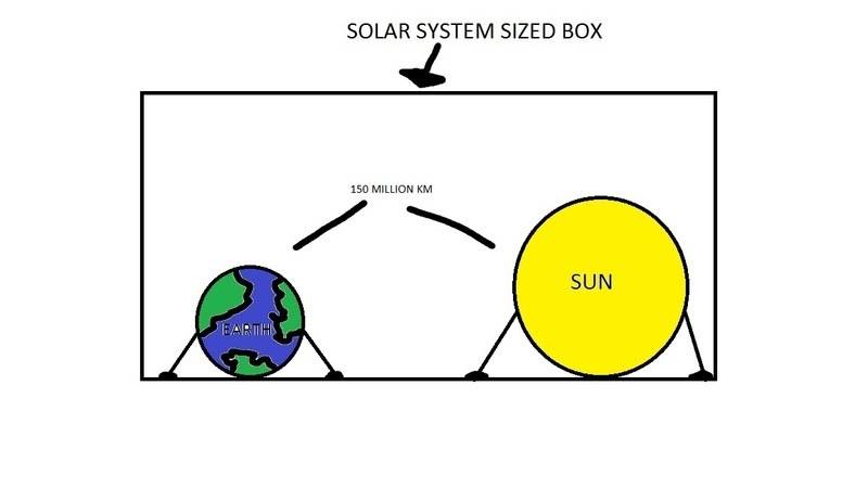

Hi, a friend and I were talking and a question came up about a delayed force.
It goes like this:
This is hypothetical obviously.
You have the sun and the Earth pulling on each other because of gravity. (The force of the pull between them does not matter, it just has to be equal.)
The sun and the Earth are bolted down inside a gigantic solar system sized box, lol. So if one moves the other moves because they are both bolted to the box.
I attached a visual to help see what I mean.
The space between them inside the this box is 150 Million KM. Now the interesting part, the sun will at some point disappear (or shut off its gravity I guess, lol, doesn't really matter). The time taken for the sun to shut off its gravity or disappear is 1 minute. I assume that it would take a total of 8.3 minutes before the force pulling the Earth and thus making the net overall force on this box since they are bolted to it, becomes unequal. When the force does arrive and stop pulling the earth, since there was a 7.3 minute (sun took 1 minute to shut off) window where the sun was not there gravitationally to be pulled on from the Earth and the Earth was still feeling that pull from the sun even though it was not there gravitationally again, would that cause the box to move? Would that delay cause the Earth to experience the force and thus cause a overall net force on the box causing it to move?
I don't care how fast that force causes the box to move, just whether it ultimately will or not.
Every way my friend and I think about it, we think the answer is yes, weird but still a yes.

Not exactly - the delay to experience the sudden absence of the Sun means that the Earth+box keep doing what they were always doing. Though bits of the box will discover the absence of the Sun before the Earth does, and bits later, which should stress the box quite a bit (though probably not as much as the original setup - the tidal forces on the box must be huge! Or did you imagine the box is massless?)
You may want to think about this in terms of a Cavendish apparatus... where one mass is removed very quickly.

Well you didn't need it - Newton's 3rd law tells you that this happens anyway. That's what an orbit does... the Sun and the Earth orbit each other about their common center of mass.
The Cavendish experiment does something like this ... but in an attempt to measure G in Newtonian gravity. You set up two small masses and quickly remove the the big one and measure the effect on the little one. You have to do it carefully.
But you are interested in the delay ... a less magical experiment would involve separating two masses, originally quite far apart, very quickly. But you could just measure the gravity waves from a distant rotating but massive system like a pair of stars or something.

Ah so you are not thinking of the Earth in orbit - but more as two masses which would gravitate towards each other but for this box ... you remove the mechanical opposition (the walls keeping the masses apart because one end is no longer anchored) but keep the gravity? (you could imagine that whatever holds the Sun to the box stops working so now the box can slide past the Sun.)
Remaining mass suddenly starts accelerating since it now experiences an unbalanced force... which would clue the inhabitants of the remaining mass into the disappearance ahead of time ... which would be faster than light communication...
You'd be correct ... but that is because the model has too many idealizations: it's broken. What happens is the tension in the box walls does not dissipate right away. As far as the remaining mass is concerned, the box walls are still pushing back against it's weight.
It is quite common to find that common classical idealizations result in relativity violations. In this case it is the rigidity of the "box".

I see 2 choices for the box 1. it is rigid, or 2. it is springy(compressible ) . In one the Earth and sun begin to move right away. In the other the sun begins to move right away but the Earth only 8.3 minutes afterward. Do you see oscillations of movement occurring also?

So in your hypothetical box, the force the box is applying to separate the sun and Earth also disappeats instantly? What is this box made of?!
The outcome of a thought experiment that violates the laws of physics can be whatever you wish, depending on how you choose to write the laws of your fictional universe.

The presence of the box is obfuscating the principle. It's not that you can't have it in a thought experiment, it's just that it introduces so many irrelevant factors that must be considered, they will bog you down.
Changes in the gravitational pull of the sun will indeed take ~8 minutes before Earth feels them. The sun can't disappear but if it rapidly accelerated away far enough that its effect on Earth were dramatically reduced, then Earth would continue to orbit as normal for 8 minutes, after which its path would begin to straighten out along the tangent of its orbit.
It would be exactly like if you swung a pail of water on a string in a circle around you, then let the string go. The pail would travel in its circular path until the wave of released tension traveled the length of the string.

Okay, is the box closed? If so, then it is a closed system. The mass of the sun remains in the box. The box may shift, but will come to rest again with the centre of mass still inside the box (though not necessarily at the same place inside the box.)
Maybe another way to phrase the question would be that there is a space probe stationary 1 AU from the Sun firing its thrusters towards the Sun to stop it from falling towards it. All of a sudden the Sun disappears from the area (rapidly accelerates elsewhere or an anti-Sun annihilates with it and its mass-energy is quickly dispersed as photons) and around this time the space probe runs out of fuel (not sure if relativity of simultaneity will affect this). For the next ~8 minutes, will the probe accelerate towards where the sun once was until the "gravitational wave" meets it?
