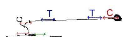

I am not sure I get the concept of centrifugal force..
If we have a stone tied to a thread and we just spin it in a circle, and while we are spinning it in a circle, the thread breaks and the stone flies off tangentially.
If we watch this motion from an inertial frame, which force will be responsible for making the stone fly of tangentially? Since, when seen from an inertial frame, there is no centrifugal force..
Another case could be :
An object is placed on a frictionless disk and the disk is rotated about its axis with some velocity. When we see the motion of the object from an inertial frame, we will see that stone first slides to the end of the disk and then flies off tangentially ( right? since there is no friction )
Again, which force will be held responsible for this motion? Could it be centrifugal force? I've learned that centrifugal force is a pseudo force used to validate Newton's equations when we see the motion of an object from a non- inertial frame.
So which force is responsible for this tangential motion?

Forces are needed to change the velocity of an object. (That's why you need a centripetal force to keep something moving in a circle.) No force is needed to make something fly off tangentially--it's just inertia in action, Newton's 1st law.
Looked at from an inertial frame there is no need for any centrifugal pseudo force when something moves in a circle.
Tangental motion implies a straight line, so no force is required (at least no lateral force) for straight line motion.
As far as the terminology, the string exerts a centripetal force on the rock, and the other part of the Newton third law pair is: the rock exerts a reactive outwards force on the string as a reaction to the centripetal acceleration, sometimes called a reactive centrifugal force, which is a real force in a inertial frame. Wiki article:

Cromptu: Doc Al is right. There is no centrifugal force acting on the stone. There is no force that accelerates the rope outward either. All forces are toward the centre, including the force on the person causing holding the other end of the rope.
In order to swing that rock you have to lean in the opposite direction - outward from the actual centre of rotation. Both you and the rock rotate about the centre of rotation. Everything accelerates toward the centre. Nothing accelerates away from the centre.
There are no outwards accelerations, but the rock exerts an outwards reactive force on the string (the outwards reactive force is in response to centripetal acceleration of the rock by the string).
Nope. The force by the stone on the string points outwards.

Andrew Mason said:
If the forces on the rope and the the stone were equal and opposite there would be no acceleration, which is not the case.
Are you saying that the force that the stone exerts on the rope is not equal and opposite to the force that the rope exerts on the stone? (In direct violation of Newton's 3rd law.)
I am saying that it is correct to say, in my example, that A exerts a force on B by means of the rope, and B exerts an equal and opposite force on A and both forces are directed toward the centre of rotation. If you want to examine the forces between the stone and rope you have to look at what the rope is connected to. If it is connected to nothing, there is no force on the rope and the rope exerts no force on the stone. If it is connected to something, the force on the rope and the rope on the stone depends on what is at the other end of the rope.
In my view, we should not confuse students by introducing a useless and misleading concept of a "real" centrifugal force. This is not a concept taught in many physics texts. When it has been mentioned in a text (eg.Delo E. Mook & Thomas Vargish (1987). Inside relativity) it is wrong (the statement that the Earth exerts a centrifugal reaction force on the sun). Even the Wikipedia page (http://en.wikipedia.org/wiki/Reactive_centrifugal_force ) is wrong (eg. centrifugal clutch is an example of the pseudo centrifugal force as it is the inertia of the rotating parts of the clutch that cause the clutch to engage, not an outward accelerating force). Are you aware of a reputable text that even mentions it?

I don't get what the issue is here? The rope exerts an inward radial force on the stone and the stone exerts an equal and opposite (i.e. radially outward) force on the rope. It is standard to call the inward radial force on the stone from the rope the centripetal force and some sources will call the outward radial force on the rope from the stone as a reactive centrifugal force, not to be confused with the inertial centrifugal force that arises in rotating frames. So, I ask again, what's the issue?
I suggest some people here stop trying to argue by shouting, and try drawing free body diagrams (including the acceleration!) instead.
If you make this much of a meal of the simplest possible case, circular motion of rigid bodies at constant angular velocity, God help you if you ever try to understand the general motion of flexible bodies!.

There is really no issue other than choosing to call the third law pair to the centripetal force on the stone "centrifugal".
Centrifugal means fleeing the centre (of rotation). There is no way that the third law pair to the centripetal force on the stone can possibly cause any part of the rope to flee the centre of rotation.
I suggest that "centrifugal" should not be used to describe the 3rd law pair to the force on the stone. In my view, it simply adds confusion and makes it even more difficult for students to understand that centrifugal "forces" (ie. those that cause objects to flee the centre of rotation) are really just inertial effects and not real forces.
As far I can say this is the core of the issue:
