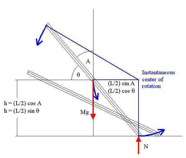

A thin uniform stick of mass [tex]m[/tex] with its bottom end resting on a frictionless table is released from rest at an angle [tex]A[/tex] to the vertical. Find the force exerted by the table on the stick at the moment of release. Express your answer in terms of [tex]m, g[/tex] and [tex]A[/tex].
Ive been reliably informed (from the lecturer) that angular momentum is to be used but I don’t really understand how, or how it would effect the force exerted by the table.
Any help is appreciated
picture is here
http://picturerack.com/users/includes/flopt.asp?todo=3&inp=/richiec/

Think of the forces acting on the rod. Draw the free body diagram of the rod. So which way will the center of mass of the rod fall? .
The instantaneous center of roation is a point about which the rod will appear to purely rotate for that instant.
Remember, the instantaneous center of rotation need not lie on the rod itself and will also be at different points as the rod falls. Once you find that point, since you know that the rod appears to purley rotate about that point, find the torque due to the various forces. Also find a relation between the acceleration of the center of mass and the angular acceleration about the center of rotation and you should be able to calculate the Normal force.

Dan, I don't think you can use v=(l/2)w in this case. Look at the motion of the point in contact with the ground. The velocity of that point is always parallel to the ground. The center of mass falls in a straight line with its velocity perpendicular to the ground. So the the center of rotation is at a point from which both these velocites are perpendicular.
So we have
[tex]mg - N = ma[/tex]
as the only forces are in vertical direction. In fact this is why the COM falls in a straight line
[tex]mg\frac{l}{2}\cos\theta = I\alpha[/tex]
The Torque due to the Normal is 0. Because the perpendicular distance from the Normal force to the center of roation is 0.
[tex]I=\frac{1}{12}ml^2 + \frac{1}{4} ml^2(\cos\theta)^2[/tex]
From parallel axis theorem
and also
[tex]a=\frac{l}{2}(\cos\theta)\alpha[/tex]
From this N can be found.
EDIT: The angle theta is between the horizontal and the rod.

I am not talking about the point of contact with the ground. I am talking about the instantaneous center of rotation.
To find it, first Draw the diagram of the rod at an angle theta(with horizontal).
Draw arrows indicating the direction of velocites of the end of the rod in contact with the ground (parallel to the horizontal) and the velocity of the center of mass. Now draw two perpendiculars to the velocity arrows you have drawn. The point where they meet is the instantaneous center of rotation. About this point the body purely rotates for that instant.
In your case, you assumed that the COM is falling with a velocity v and angular velocity is w about the Center of Mass. Calculating the velocity of the point in contact with the ground we get, v(P)=-vcm(j) + l/2wsin(theta)(i) + l/2wcos(theta)(j).
But the velocity of that point is directed along the x-axis only. Therefore the y-component of the velocity is 0.
From that you get v=l/2wcos(theta) and NOT v=(l/2)w

The torque in your equation [itex]mg\frac{l}{2}\cos\theta = I\alpha[/itex] is the torque about the contact point. The statement that the torque due to the normal is zero is only true if the contact point is the point of rotation. If there is some other point of rotation, then the normal force produces a torque.
Your assertion that the velocity of the point of contact is horizontal is clearly correct. The floor constrains the motion. Look at what that velocity is in relation to the CM.
[tex]v_{cm} = -v_{cm}j[/tex]
[tex]v_P = -v_{cm}j + \frac{L}{2}\omega sin(\theta)i + \frac{L}{2}\omega cos(\theta)j[/tex]
and their DIFFERENCE describes the relative motion between them
[tex]v_{rel} = v_P - v_{cm} = \frac{L}{2}\omega sin(\theta)i + \frac{L}{2}\omega cos(\theta)j[/tex]
The relative velocity is perpendicular to the rod, and its magnitude is l/2w, as it must be. If you were in the center of mass frame of reference, you would see the end of the rod in circular motion around you at a distance L/2, a fact that you used to figure out the horizontal velocity of the contact point.

Doc Al said:
Why wouldn't mechanical energy be conserved?
Because work is being done on the rod by the normal force. Just because the point of contact of the force with the rod is not moving does not mean the object as a whole is not moving. We know the center of mass will move. I need to add a term that accounts for the F(h).dh
Maybe I'm missing something (besides a few marbles), but why not treat this as a straightforward dynamics problem?
From Newton's 2nd law:
[tex]N (L/2) \sin A = I \alpha[/tex]
The rotational inertia about the cm is:
[tex]I = 1/12 m L^2[/tex]
The constraint of the contact point slipping along the floor gives:
[tex]a = \alpha (L/2)\sin A[/tex]
Solving the above, I get:
[tex]N = mg/(1 + 3\sin^2 A)[/tex]

I think I have finally caught up to you and siddharth on this thing. You are right of course about the conservation of energy. I guess I had a serious brain burp, or a senior moment on that one. siddharth was right all along on the velocity issue, though it took me to his latest discription to get in touch with his instantaneous center of rotation notion. A picture is helpful in this regard, so I drew one up and am posting it here. Please check it siddharth and make sure I have interpreted it correctly. The diagram does seem to fit with the case you were making and the final result.
I did manage to work through the energy approach and got the same result once I fixed the velocity to angular velocity relationship. It does not add anything to what has already been done, except that in the course of doing it I believe I have extended the problem to the case of what happens to the normal force after the rod is in motion. It is not a closed form solution because there is a term that depends on the angular (or linear if you want to put it in those terms) velocity. It is posted here from the F = ma and [itex]\tau = I\alpha[/itex] point of view that you followed, and includes the calculation of the relationship between a and [itex]\alpha[/itex] that leads to the velocity dependence of the normal force.
Newton's second law
[tex]h = \frac{L}{2}\cos A[/tex]
[tex]\frac{{dh}}{{dt}} = - \frac{L}{2}\omega \sin A = v[/tex]
[tex]\frac{{d^2 h}}{{dt^2 }} = - \frac{L}{2}\left( {\alpha \sin A + \omega ^2 \cos A} \right) = a[/tex]
[tex]N - mg = ma = - m\frac{L}{2}\left( {\alpha \sin A + \omega ^2 \cos A} \right)[/tex]
[tex]N - mg = - \frac{{mL\alpha }}{2}\sin A - \frac{{mL\omega ^2 }}{2}\cos A[/tex]
Torque
[tex]N\frac{L}{2}\sin A = I\alpha {\rm{ ; }}I = \frac{{mL^2 }}{{12}}[/tex]
[tex] \frac{{N\sin A}}{2} = \frac{{I\alpha }}{L} = \frac{{mL\alpha }}{{12}} = \frac{1}{6}\frac{{mL\alpha }}{2}[/tex]
[tex]\frac{{mL\alpha }}{2} = 3N\sin A[/tex]
Substituting
[tex]N = mg - 3N\sin ^2 A - \frac{{mL\omega ^2 }}{2}\cos A[/tex]
[tex]N\left( {1 + 3\sin ^2 A} \right) = mg - \frac{{mL\omega ^2 }}{2}\cos A[/tex]
[tex]N = \frac{{2mg - mL\omega ^2 \cos A}}{{2 + 6\sin ^2 A}}[/tex]
For the stated condition that the Normal force at the time of release is to be found, this result reduces to your result because at that moment [itex]\omega[/itex] is zero.
I think an interpretation of this result is that if you started with an initial [itex]\omega[/itex] you might get to a point where the rotation creates separation from the floor before the rod hits flat. I'm wondering if it might happen even if you release the rod from rest. I dropped a pencil a few times, and it looks to me like there might be separation before it hits, but it is hard to tell. Someone else might want to explore that and get a closed form solution, but I'm done with this one for a while.
That is a very nicely drawn picture OlderDan! thanks for posting it. Has it been assumed that the right end stays in contact with the table throughout the whole motion? It seems like that would be true, but how do we know for sure?
The original problem is only asking for the normal force when the rod is first released, so it is not an issue for the problem. The wording of the problem is suggestive that things change after the rod starts moving, and I believe I have shown that to be the case. I suspect that it might not maintain contact throughout, at least if started high enough, but I certainly have not demonstrated that, and I'm not sure.
wow! its amazing how tricky a simple enough looking question can get! It seems as if the answer posted by several of you is correct by a majority vote. I have learned a lot from this thread. Thankyou. I will be getting the solution to this next week. I will post what my lecturer has to say about it.
Thanks again
