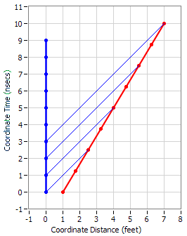

We have to be clear here: observers cannot actually see Time Dilation. What they can see is what is known as Relativistic Doppler and for observers moving away from each other it is a bigger factor than Time Dilation but it is also symmetric.
For example, let's suppose that two observers are moving away from each other at 0.6c. Here is a spacetime diagram showing the rest frame of the blue observer as he sees the one-nanosecond ticks of the red observer's clock. The ticks are indicated by the dots and the images of them are transmitted along the thin red lines:
The Time Dilation factor at 0.6c is 1.25 and you can see that in this frame, the dots for the red observer are spaced farther apart than the Coordinate Time by the factor of 1.25. However, the blue observer cannot see the distant coordinates, he can only see when the images of each tick reach his eyes and they are spaced by a factor of 2. In other words, 2 nanoseconds go by on his clock for every one that he sees on the red observers clock.

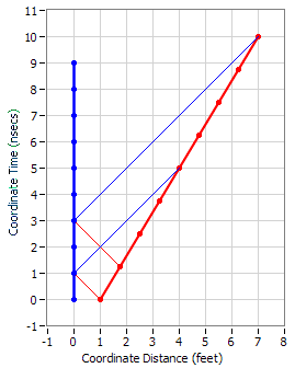

Now the same thing is happening for the red observer as he watches the blue observer's clock. Here is a spacetime diagram in the same frame but showing the images of the one-nanosecond ticks as they are transmitted from the blue observer to the red observer:
Even though this is the rest frame for the blue observer, it still correctly shows the symmetry of Relativistic Doppler as the red observer sees the blue observer's clock tick once for every two of his own.
Note that in all of these diagrams, the speed of light is 1 foot per nanosecond and travels along the 45-degree diagonals.

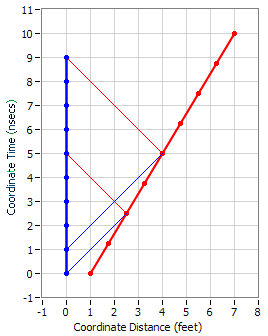

Yes, either observer can use light signals and the assumption that they travel at c (1 foot per nanosecond) to determine the Time Dilation of the other observer's clock. Here's how they do it:
Each observer sends a light signal to the other observer which reflects off of him and returns. The observer sending and receiving the light keeps track of when he sent it according to his own clock and when he received the reflection as well as the observed time on the other ones clock. He then assumes that the light traveled at c both going and coming and averages the two times to get the time at which the image of the other observer's clock was sent according to his rest frame.
Finally, he has to repeat the process which gives him a pair of differences for his own clock and for the other observer's clock. Dividing these gives him the Time Dilation factor based on his own reference frame.
Here is a spacetime diagram showing the light signals that the blue observer reflects off of the red observer:
At the blue observer's time of zero, he sends the first light signal to the red observer which reflects back to him at his time of 5 nanoseconds along with the image of the red observer's clock at 2 nanoseconds. The average of 0 and 5 is 2.5 nanoseconds at which time he assumes the red observer's clock displayed 2 nanoseconds.
Next, the blue observer sends a second light signal at his time of 1 nanosecond and receives the reflection at his time of 9 nanoseconds which averages to 5 nanoseconds. He sees the blue observer's clock at 4 nanoseconds.
Now he takes his own calculated time difference, 5-2.5=2.5 and divides that by the observed difference in the red observer's clock, 4-2=2, to get 2.5/2=1.25 as the Time Dilation Factor.

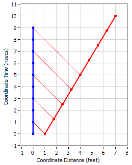

Now since this is symmetrical, here is a spacetime diagram showing how the red observer determines the Time Dilation of the blue observer's clock according to his own rest frame, even though the diagram is for the rest frame of the blue observer:
For the first light signal, the red observer takes the average of 0 and 4 which is 2 corresponding to the blue observer's time of 1. Then he takes the average of 1 and 8 which is 4.5 corresponding to the blue observer's time of 3. Finally, he takes the differences of 4.5-2=2.5 and 3-1=2 and dividing these yields 2.5/2=1.25 as the Time Dilation Factor.
