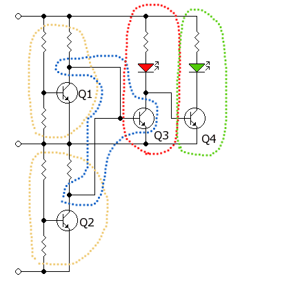

Here is a very halfbaked version of what I am thinking. Yes, I know this particular circuit would never work. I want it to be crude but I think I'm overcrudifying. Just help me think it through...
The orangeish sections are the two voltage sensors. When the voltage drops below a certain threshold, the base voltage, because of the divider, drops below the 0.6 V turnon of the transistor, turning it off.
The blue section is supposed to be an OR gate, but wouldn't really work as shown. It would have to be the opposite, so that one of the voltage sensing transistors turning on would indicate a low battery. Otherwise it's a NOR instead of an OR. Also the voltages wouldn't work because one is driven by the other supply.
Could Q2's collector go to V+ instead of ground? Then when the transistors turned on (however that would magically work), one of them would pull the OR gate down to either ground or V-. Either would work, so it would be a crude but functional OR gate.
Then the red section turns on the red LED, of course, and that pulls the input to Q4 low, turning off the green.
Did I at least get that stage correct?
It seems like you could collapse the green section into the first section, though, making it three transistors. Q1 and Q2 become two alternate paths for the green LED current, which... oh wait that wouldn't work either.
Is there any way to provide the opposite functionality of Q1 and Q2? (With PNPs perhaps)? In other words, it would have a pull-down resistor so that it could OR and the transistors would turn ON when the base voltage dropped too low.
Does this inspire any ideas?

>Hmm.. It really needs all that?
Actually, the circuit you show in your attachment is very similar to the one on my Post-It. Except I had one for the + battery and one for the - battery. Do you want just one set of LEDs for both batteries?
Ahh.. yes I only want one green LED and one red LED. The green will light when both batteries are full and power to the circuit is connected, the red LED will light when either battery drops below a certain level. Can you scan your post-it or sketch a picture? You can draw a schematic like I did with Klunky schematic editor, screenshot, save, and upload.

I'll just throw it into Spice so I can figure out ballpark resistor values, then post a screenshot. I probably won't get to it until Monday, though. PM me if I forget. My version right now is for the positive side only. I'll see if I can think of a simple way to OR in the negative side too...
Okay, here's the quick version -- no optimization or anything. My first swag at resistor values worked well enough that I didn't change anything. The trip points are about 10V on the way up (for Vbatt = V1 supply) and 7V on the way down. You can tune the resistors to set the trip points and hysteresis wherever you want for your particular battery. Again, keep in mind that the trip points will move with temperature, so depending on how sloppy you can let your application be, you might want to add some temperature compensation parts (but that means you'll need to start adding at least a zener diode, for example).
In the screenshot, the supply is at 10V, which is just enough to keep the left green led on as the supply decreases. When it gets down to about 7V, the left green LED snaps off, and the right green LED snaps on. Then as you raise the supply back up, the LEDs snap back the other way when you cross up through about 10V, and stay that way up to 12V.
Hope this helps. I didn't spend any time thinking about the negative battery stuff. You can either just complement this circuit for PNPs and add 2 more LEDs to get the separate indication for the negative battery, or just complement the voltage reference (the leftmost NPN) to a PNP version down in the negative battery stuff, and figure out how to use that to OR into the control stuff for the NPN differential pair. -Mike-
