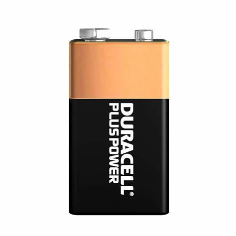

If it is the standard PP3 type like this ...
and the bulbs/globes are more than about 1/4 watt The battery won't last long
as those batteries can only supply around 300mADave
