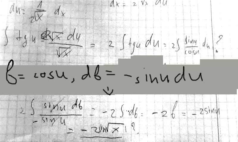

ok. explain me how solve " ln |sec u + tan u| + C" if x=2tgu
U know . I`ve done 3 and 4. =)
See in atach and say right or wrong.
In 4 a had two variants of result. Please tell which off them is right.

You did number 3, and 4 correctly. Congratulations. :) In number 4, you can leave it in the form:
[tex]\frac{2}{\ln 2} 2 ^ {\frac{x}{2}} + C[/tex], it's okay.
Number 5 is a little bit messy.

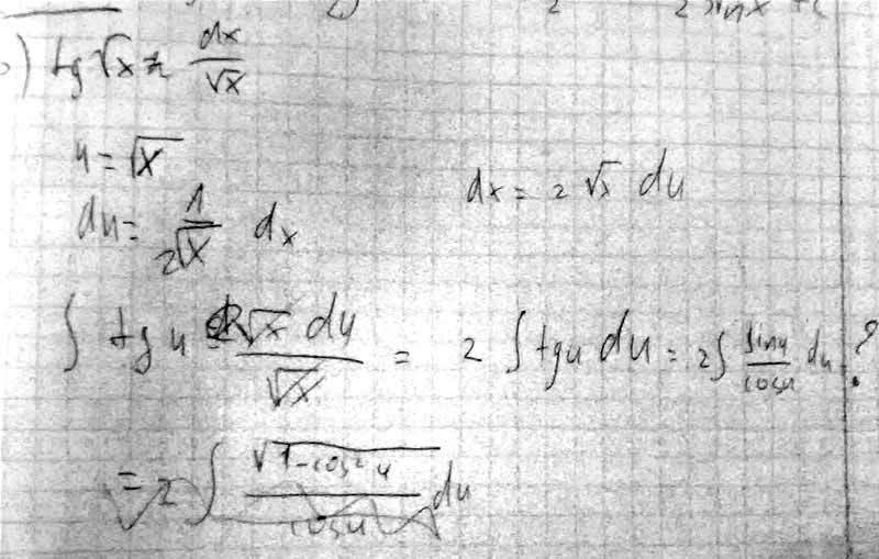

with 10... i don`t know how to start! Please people help.
Remind :

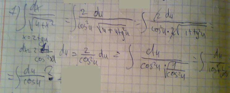

7 - not competed. explain me how solve " ln (sec u + tan u) + C" if x=2tgu.
9 - please where tell where a I have mistake.
10 -Try to solve it... or tell how to start...
And that's all! =) My home work will be completed... Really please help, becouse now 20.25 pm on my clock... and i must go to bed... becouse i`m early get up, nearly 6 o`clock. (university is far from me)

7. When seeing some integral in this form:
[tex]\int \frac{dx}{\sqrt{x ^ 2 + \alpha ^ 2}}[/tex], one should think right away about making the trig-substitution [tex]x = \alpha \tan t , \quad t \in \left] -\frac{\pi}{2} ; \ \frac{\pi}{2} \right[[/tex]
It goes like this:
[tex]x = \alpha \tan t \Rightarrow dx = (\alpha \tan t)'_t dt = \alpha \frac{1}{\cos ^ 2 t} dt[/tex]
Your integral will become:
[tex]... = \int \frac{\frac{dt}{\cos ^ 2 t}}{\sqrt{\alpha ^ 2 + \alpha ^ 2 \tan ^ 2 t}} = \int \frac{dt}{ \cos ^ 2 t \sqrt{\alpha ^ 2 \left(1 + \tan ^ 2 t \right)}}[/tex]
[tex]= \int \frac{dt}{\cos ^ 2 t \sqrt{\frac{1}{\cos ^ 2 t}}}[/tex], since [tex]t \in \left] -\frac{\pi}{2} ; \ \frac{\pi}{2} \right[[/tex], so cos t > 0, we have:
[tex]... = \int \frac{dt}{\cos ^ 2 t \sqrt{\frac{1}{\cos ^ 2 t}}} = \int \frac{dt}{\cos ^ 2 x \frac{1}{\cos t}} = \int \frac{dt}{\cos t}[/tex]
Now the power of cosine function is odd (in this case, 1), we'll make the substitution u = sin x, otherwise, when the power of sine function is odd, we make the substitution u = cos x.
[tex]... = \int \frac{\cos t dt}{\cos ^ 2 t} = \int \frac{\cos t dt}{1 - \sin ^ 2 t}[/tex]
Now let u = sin t, du = cos t dt, so the integral becomes:
[tex]... = \int \frac{du}{1 - u ^ 2} = ...[/tex], pretty straightforward from here. Can you go from here? :)
Number 10, Integration by Parts, you should remember LIATE. :) See post #67. What should u and dv be?
Number 9, you should do it using [tex]u = \ln (x) \quad dv = x ^ {-\frac{1}{2}} dx[/tex]. It should be easier.
Btw, you've differentiated incorrectly. You still have ln(x) in your du, so it's impossible to do it by letting [tex]u = \ln x x ^ {-\frac{1}{2}} \quad dv = dx[/tex]:
[tex]u = \ln x x ^ {-\frac{1}{2}} \Rightarrow du = \left( (\ln(x))' x ^ {-\frac{1}{2}} + \ln (x) \left( x ^ {-\frac{1}{2}} \right) ' \right) dx[/tex]
[tex]= \left( \frac{1}{x \sqrt x} - \frac{1}{2} \frac{\fbox{\ln(x)}}{x ^ {\frac{3}{2}}} \right) dx[/tex]

about 7: [tex]... = \int \frac{du}{1 - u ^ 2} = ...[/tex] By what formula i must integrate? becouse i can`t find it..

[tex]... = \int \frac{du}{(1 - u) (1 + u)} = \frac{1}{2} \int \frac{(1 - u) + (1 + u)}{(1 - u) (1 + u)} du = \frac{1}{2} \int \left( \frac{1 - u}{(1 - u) (1 + u)} + \frac{1 + u}{(1 - u) (1 + u)} \right) du[/tex]
[tex]= \frac{1}{2} \int \left( \frac{1}{1 + u} + \frac{1}{1 - u} \right) du = ...[/tex] You should be able to go from here. :)There are several ways to go about integrating 1/cos(x) = sec(x) (sec(x) is another way to write 1 / cos(x)), this is one of the two common ways, the other way is:
[tex]\int \sec(x) dx = \int \sec(x) \frac{\sec(x) + \tan (x)}{\sec(x) + \tan (x)} dx = \int \frac{\sec ^ 2 x + \sec (x) \tan (x)}{\sec(x) + \tan (x)} dx[/tex]
Let u = sec(x) + tan(x)
[tex]\Rightarrow du = \left( \frac{1}{\cos x} + \tan(x) \right)'_x dx = \left( \frac{\sin (x)}{\cos ^ 2 (x)} + \frac{1}{\cos ^ 2 x} \right) dx = \left( \sec(x) \tan(x) + \sec ^ 2 (x) \right) dx[/tex]
The integral will become:
[tex]\int \frac{du}{u} = \ln|u| + C = \ln |\sec(x) + \tan(x)| + C[/tex]

Ok, if x = 2 tan(u) ~~~> x / 2 = tan(u)
Note that [tex]u \in \left] - \frac{\pi}{2}; \ \frac{\pi}{2} \right[[/tex], so cos u > 0, we have:
[tex]\tan u = \frac{x}{2} \Rightarrow 1 + \tan ^ 2 u = 1 + \frac{x ^ 2}{4} \Rightarrow \sec ^ 2 u = 1 + \frac{x ^ 2}{4} \Rightarrow \sec u = \sqrt{1 + \frac{x ^ 2}{4}}[/tex], so plug it to the expression above, yields:
[tex]... = \ln \left| \sqrt{1 + \frac{x ^ 2}{4}} + \frac{x}{2} \right| + C[/tex]
