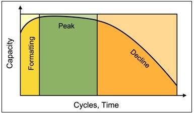

Would a battery connected this way last longer than one that sits idle uncharged for 6 months?
It would depend on the where in it's lifetime (number of deep cycles) the battery is.
And how it's been charged in the past.

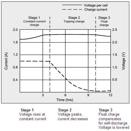

The correct setting of the charge voltage is critical and ranges from 2.30 to 2.45V per cell. Setting the voltage threshold is a compromise, and battery experts refer to this as “dancing on the head of a needle.” On one hand, the battery wants to be fully charged to get maximum capacity and avoid sulfation on the negative plate; on the other hand, an over-saturated condition causes grid corrosion on the positive plate and induces gassing.
Quote and Images compliments of http://batteryuniversity.com/learn/
So this would be 14.7 at most if I install two diodes in line this would be a crude way of lowering voltage enough. Summer months it was putting out 15 volts must be cold factor more voltage and or amps. I know LM317 would work but have more diodes laying around.
