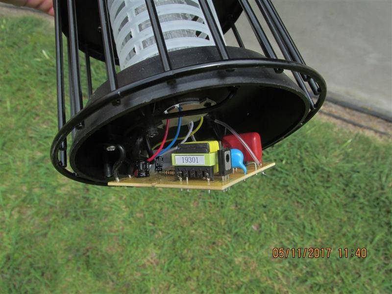

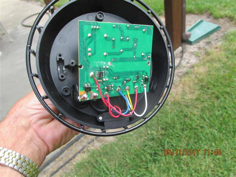

Here are 2 pics - couldn't get the board any further out with all the wires connected.

OK, I'm assuming the two thicker black wires on the lower left of pic #1 are the input power connections?
Those are connected to a 4-lead device, so that is most likely the full-wave (bridge) rectifier I mentioned earlier. That should make it universal for AC/DC ( but there can be exceptions, since the peak of a rectified AC signal will be 1.4x the peak of a DC, and/or, they could still be looking for a 60 or 120 hertz signal for other purposes). But I really, really doubt those exceptions apply.
Are the markings on that part a (+) and a (-) and a (~)? That's how they usually mark packaged bridge rectifiers. I think you are good to go - Jim Hardy's idea of connecting through a 12 V auto bulb is a good one in any case, just to see if there are any load issues.
Yes, incoming up through the stake. The only 4 leads I see are the blue, yellow, red, and white? They go Up into the zapper body in pic #2, and since this a "dual function" unit, I don't think it's a rectifier? Don't see any markings as you suggest. The 2 "modes" are "LED only", and "zapper mode with UV light", so just 2 separate circuits? The extra red wire is going in and out of the push button to toggle between modes. It's in that 'block with the silver screw' at the bottom of pic #1.

PS - The black and yellow 'box' in pic #2 has 5 places it's connected to the board. "19301" is on the side of it. Also, the large Orange part has 'CBB81' and '2000V223J' printed on it. Not sure if this info helps?
I see 2 black wires in the lower left of pic #1, and again on left of #2. Those look like the 12 V input to me - is the picture making this look different than real life? What do those wires go to? I assume some sort of 12 V connector (or just bare wires)?
The 19301 label is the transformer/inductor probably to step up the voltage for the bug zapper, the orange part is probably a 2000 Volt rated capacitor, also for the bug zap circuit, but those markings aren't always standardized.

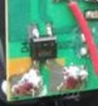

The 2 black wires are soldered to the board - the 2 brownish looking solders on the lower left corner of the board in pic #1. They show again in pic 2 on the left side corner of the board - what I did was just turn my wrist from palm up in pic 1 - to palm down in pic 2 to show the underside of the board.

I agree with NTL it looks like power comes straight into abridge rectifier.
Close-up photo of a green printed circuit board with a black rectangular component in the centre, two solder pads with red-tinted solder joints below it, and a red wire at the upper right.
That thing should be impervious to polarity.
Unless it uses 60 hz for some internal timing or charge pump it will work on DC.
If i had one i'd try it .
