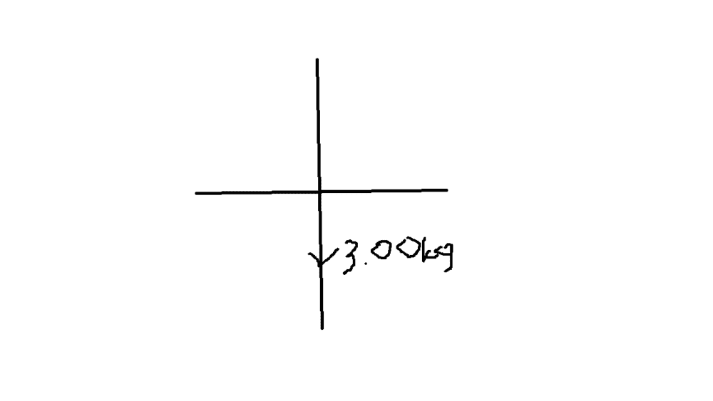

A uniform plank 1.5m long and weighting 3kg is pivotedat one end.The plank is held in equilibrium in a horizontal position by a weight and pulley arrangement.Find th e W needed to balance th plank.Neglect friction
no equation
I think that the W should be 3kg to be in equilibrium but in the book it said that id 3/√(2 I don't why
The pulley rope is attached to the end of the plank I assume. So the first thing you do for any force problem is ___________ ?
the diagram
Yes the "free body" diagram.
ok well I know that the the pulley is aright triangle so the part that is conected to the plank forms a 45 angle and i think that's something important
Draw the free body diagram and show us the details .

the Wx,Wy the gravity that affract the plank the opposite reaction of the gravity and the opposite reaction of Wx
Please draw and submit "free body" diagram: Draw the plank with no external forces ("free body") and one by one add all the labelled vector forces acting ON the plank. Then show your result. Then we can discuss.

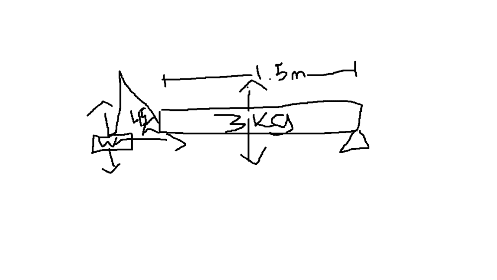

like this?

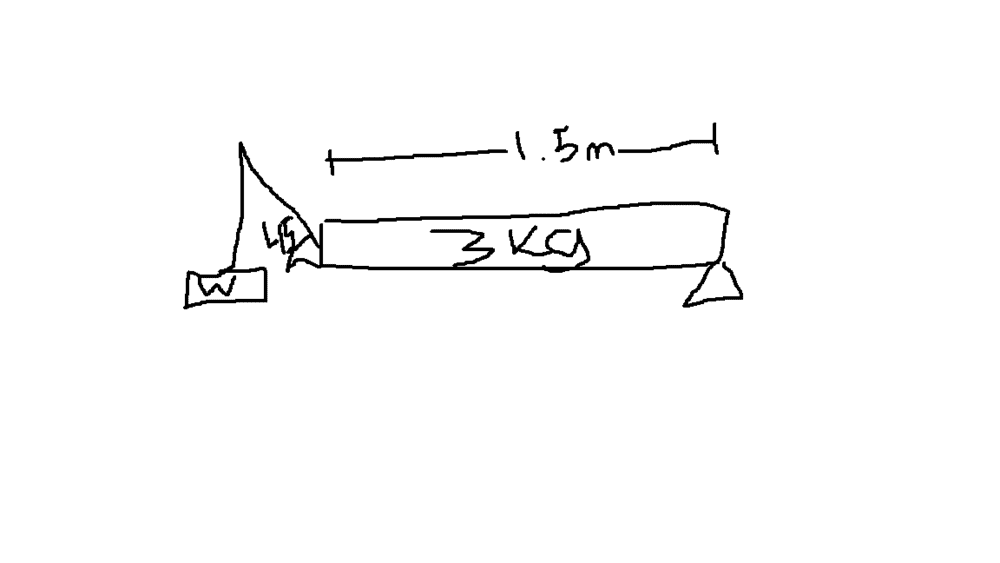

Close. But on the first drawing make a labelled arrow representing each force and its position of application. Doesn't have to be pretty (you don't really need the pulley but you do need the angle).

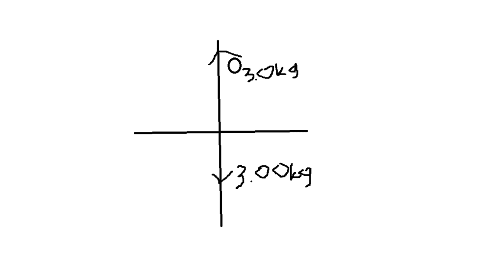

Draw a single arrow representing each and every force ON the plank (if the direction is wrong the vector will turn out negative) .
These are the tools of the trade. Has no one taught this to you previously (review as necessary!) ?
sorry I am in middle school
but the number of forces are correct
sorry what do you mean only one arrow
