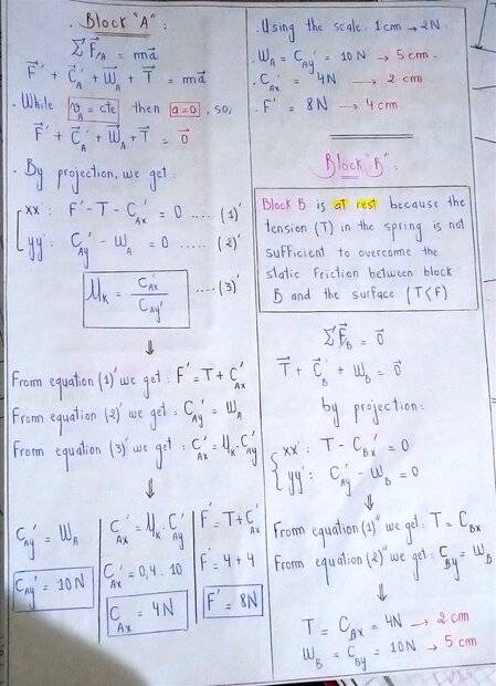

Actually, I solved half of the exercise, but i couldn't solve question 4 and 5. help me please, even with numerical application.
For example: in question 4 when calculating the ∆x = T/K , i dunno if T we take it as 4N or ( T=F⁰ =5N ) or even (T=F'=8N)
And about question 5, i dunno even how to start.

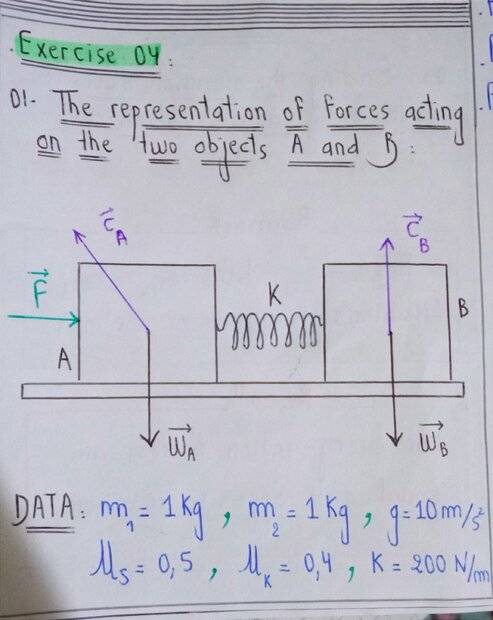

This is the exercise:
Please help me ( question 4 and 5).

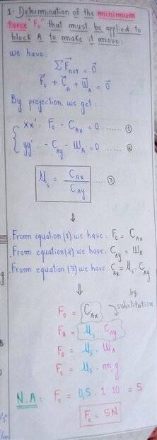

Here is my effort:
First, I represented the forces on both objects.
Then, i found F⁰ = 5N (question 1)
After that, (question 2) + (question 3)
I hope it's even correct.

For block B: in the xx' we have:
Xx': T - Cbx' = 0 which means T=Cbx
In question 4: Block B is not in motion at all, so we were asked in the question to calculate ∆x.
+ ( I know that we calculate ∆x by the formula ∆x= T/K where K=200N/m, but i dunno the exact value of T.)
+ { Here my ability to complete the rest of the exercise ended )

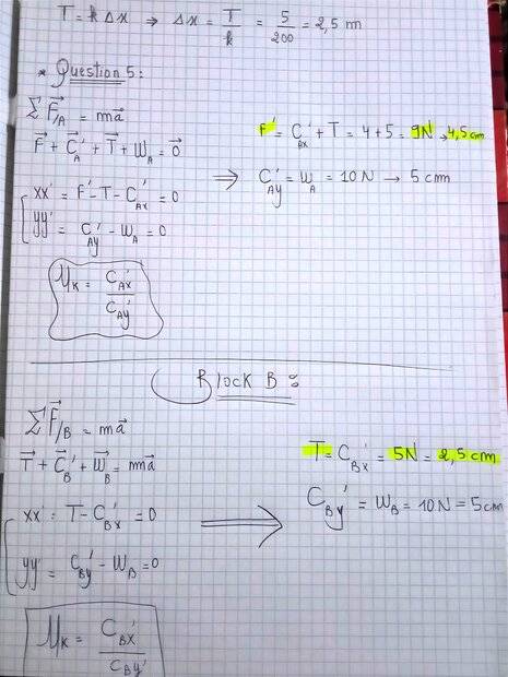

Then it's 5N , i considered the F⁰ case.
Yes, its static friction acting on block 2...it's not moving.

Bruh i wanna cry for real, if u're talking about question 4, i just understood the situation and used ∆x=5N\200 N/m. So simple 😭😭

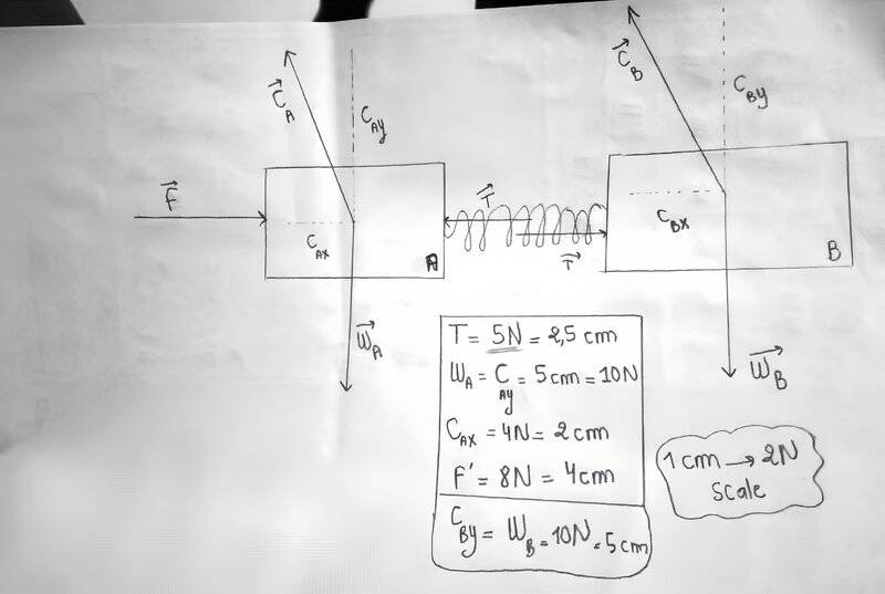

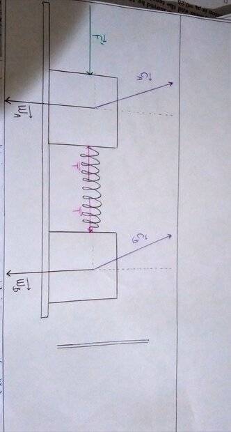

I can pitch in. Start by drawing two free diagrams, one for each block, just before block B begins to move. Draw it to scale and point out which forces have equal magnitudes. Please post your diagram right side up.
First, a nitpick: you keep writing "tension", but the spring is under compression.
So the situation is now the same as in q3 but with a different displacement.
