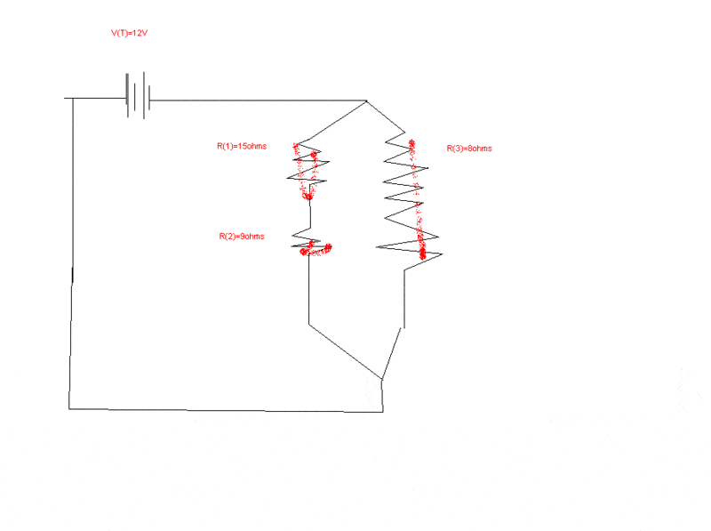

2 series resistors are in parallel with another resistor..
Resistors R1, R2, R3 have resistances of 15ohms, 9, 8.. R1 and R2 are in series and the combination is in parallel with R3 to form the load across a 12 volt battery.
a)diagram
b)total current
c)Current across R3 branch?
d)voltage/potential drop across R2?
!Series and Parallel and Combo circuit equations..

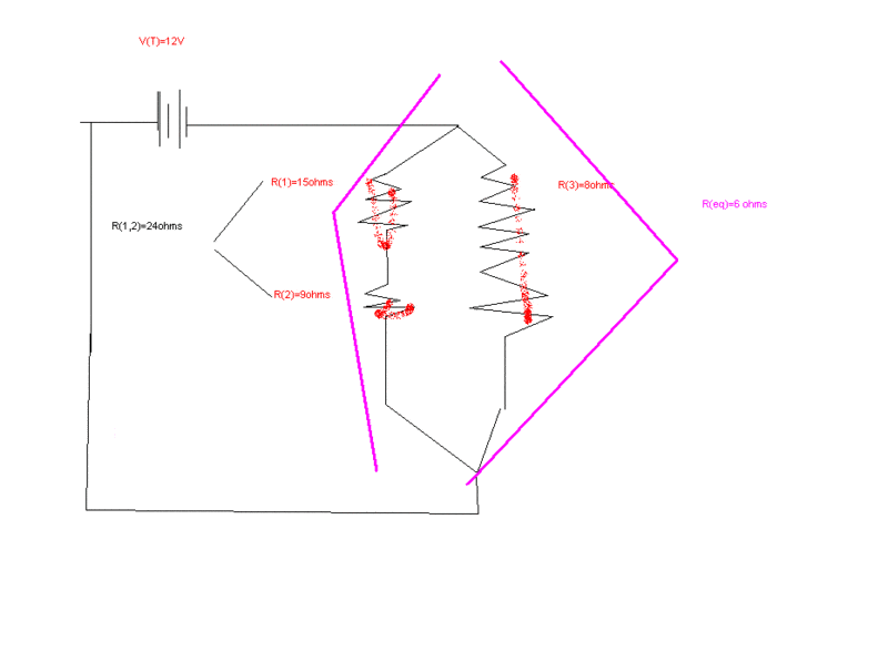

I drew it.. 1st thing I did was figure total resistance.. to do that, I combined R1 and R2 serially by adding..15+9 is 24.. Then, now that I have one and one parallel (R[1,2] and R3), I do 1/Rt=1/R1+1/R2... And got R(t) to be 6 ohms..
With R(t) calculated, and the given V(t), I can figure B, total current
I(t)=V(t)/R(t)... ding.. 2 A or 2 amps..
Now, I'm kind of lost for the rest of the problem.. What is the current in R3 branch? Erm..To find individual current of a parallel resistor, I need to know the voltage and the resistance.. I would think that the voltage of R3 be 12V.. but my teacher said it was 6V..and I had to compact the whole circuit, then repackage it to get 12V..and I'm lost:confused:
Well, assuming that for some reason, V3 is 6V.. I did I3=V3/R3... 6V/8 ohms=0.75A...that would be C
Then.. for D..I did I(t)=I(3)+I(1,2).. I(1,2)=1.25A..
So.. V2 would be I2R2.. If I(1,2)=1.25A, then I1 and I2 also equal 1.25A?
Then.. 1.25A*9 ohms.. 11.25V equals V2?
meh.. ok.. Can anyone confirm whether 2A, total current, and I3 of 0.75 A is right? And I'm pretty sure the rest is wrong.. PS, any freeware circuit drawers?
All good!
Your initial thought was correct. R3 is connected right across the 12 V battery, so of course its voltage is 12 V.
Your calculation look good until the 6V appears. Check that your teacher is saying R1 and R2 are in parallel with R3, rather than R1 being in series with R2 and R3 in parallel.
Answer A - Yes you could do with a circuit drawing package but it matches the description.
Answer B is correct for the circuit.
Given the description it is as you think 12V dropped across R3 so recalculate answer C.
You can proove that this is correct because you can use the same method to calculate the current in the R[12] branch and the sum of the two will equal answer B.
Your calculations for D are correct but the numbers are screwed up by the 6V again.

:( My teacher.. this other kid was at his desk, and showed him "3/2" for R3and he said yes, that looks like what some other kids of other classes got.. 1.5 A[12V/8 ohms] He never said 0.75A was wrong... But meh..
K, so question.. Is V1=12V? Is V2=12V?...I don't think they are but I think that V(1,2) is 12V. Why? Well, if I(t) [yes I realize that's I] is 2A, and suppose that 1.5A is right for I3.. If
V1=12V.. I(1)=12V/15 ohms is 0.8 A.. but I3+I(1) then would be more than I(t)..
For V(1,2)=12V though.. 12V/24 ohms=0.5A, fits perfectly with the R3's I3 of 1.5A, totaling up to 2A.
Also, if I'm going to say that V1 and V2 aren't 12V.. then V3 also can't be 12V..
So..maybe I have just discovered that the "parallel law" of V(t)=V1=V2 only applies to when it is one resistor parallel with another resistor, not one parallel with two.. Great.. So how am I suppose to figure voltage drop of the individual V2 then..
Nonsense. The total voltage drop across R1 & R2 is 12V, so V1 + V2 = 12V. R3 is parallel to R1+R2, so the voltages across both branches are equal.
I think it's beginning to click now. :wink:
Find the current through each branch. Then use ohm's law.
pugfug90 said:
KK..Doc Al, you agree that 1.5A is I3?
Sure. I = V/R = 12/8 = 1.5 A.
Looks like your teacher made an error. If that's how the problem was worded, your diagram is correct. V3 = 12V as you thought, and V(1,2) is also 12V. I(3) = 1.5A as you calculated, and the total current, as you calculated is 2A.
And you're further currect that since V(1,2) = 12V and R(1,2) = 24ohms, then I(1,2) = .5A
If you need to know the potential difference across either R1 or R2, simply use the current. You'll find that the two potential differences do indeed add up to 12V.
Your teacher had one of those brain farts?
Well the voltage, V3 is 12V because it connected in parallel with the voltage source and you know the current in that branch. The current flowing in the branch with R1 and R2 is the difference of It and I3. Since the same current flows through both R1 and R2, just apply ohms law to find the individual voltage drops V1 and V2. You will find that V1+V2 is 12V.

So..
I(1,2)=I1=I2..
V2=I1R2..
Since 0.5A=I(1,2)..I1=0.5A..?
0.5A*9 ohms=4.5V=V2..
Hrm. Let's figure V1 for fun..0.5A*15 ohms = 7.5V..
(V1+V2)=V(t)=V3..
Everything looks great:D I think.. My teacher confused me with his "at first, V3 is 6V and blah"..
