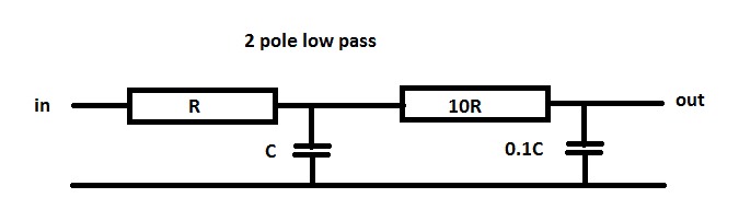

If you're cascading passive filters
downstream one needs to have at least 10X the impedance of upstream one so it doesn't load it noticeably. More would be better, 30X or 100X.
Of course whatever is connected to "out" should be 10X higher yet.
That's why it's best to buffer. But you can get away with this approach if you don't need precision.
