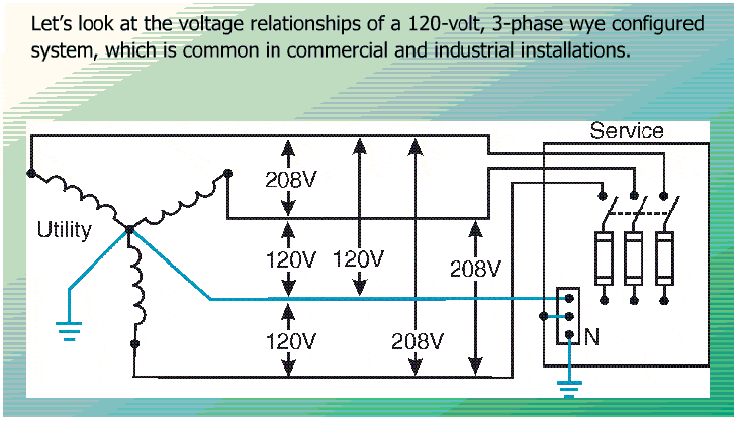

I did some browsing and came across this site:
http://www.wisc-online.com/objects/ViewObject.aspx?ID=ACE302
with the following graphic:
which seems to indicate that the voltage specification for a Wye generating system specifies the line-to-neutral (or phase) voltage of the generator. If that is true for this problem, then the line-to-line voltage will be in the neighborhood of 416V.

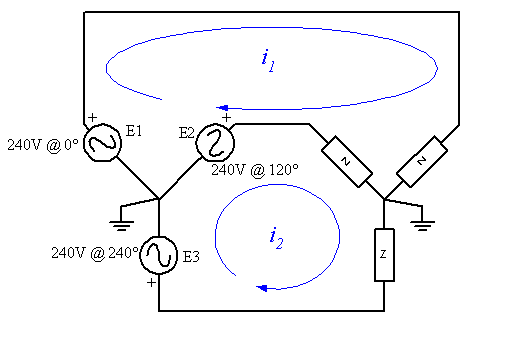

A circuit diagram would look something like:
For the impedance you can use the reactance as you've shown. You can determine the power factor for the load from its real and reactive components.
An alternative is to leave the impedance in complex form and do the calculations in complex form too (phasors). This would automatically take care of all the "1.732" and pf factors and give you the kVA, kW and kVAR values all at once. It helps if your calculator handles complex numbers :smile:
