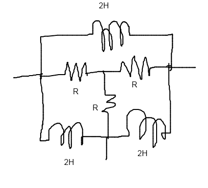

Balanced Three Phase Load System
1 reply · 2K views
JosefMTD
f = 60 Hz
pf = 0.8 (lagging)
Z(L) = 2 (pi) * f * L
Given z = x + iy
tan(angle) = y/x
pf = cos(angle)

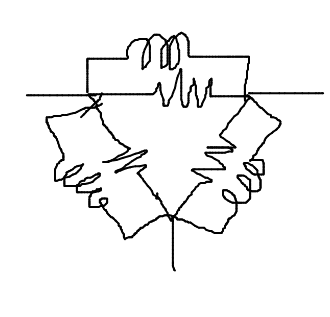

I changed the Wye-connected resistors to an equivalent Delta-connected resistors:
The new resistors become 3R in the equivalent Delta-connected resistors
Next step is calculating Z(L)
Z(L) = j*2 (pi) * 60 Hz * 2 H = 754j ohm
1/Zphase = 1/Z(L) + 1/Z(R)
1/Zphase = 1/754j ohm + 1/3R ohm = -j/754 ohm + 1/3R ohm
1/Zphase = (754 ohm - 3Rj)/754 ohm*3R ohm
Since V is not given value in this problem, I choose to use an arbitrary value of x with angle of 0 degree, thus making it a constant.
Iphase = Vphase/Zphase = x*(754 ohm -3Rj)/754 ohm*3R ohm
It's known that power factor is 0.8
cos(angle) = 0.8
angle = arc cos(0.8) = +/- 37
Since known that the current is lagging, the angle is lower than 0 degree, thus making the appropriate angle is -37 degree.
Since I know the angle of phase I, I put it in the formula to find the angle of a complex number:
tan(angle) = Im(complex variable)/Re(complex variable)
tan(-37 degree) = [(x/754 ohm*3R)(-3Rj)]/[(x/754 ohm*3R)(754)] = -3R / 754
- 0.75 = -3R / 754
R = 754/4 Ohm = 188.5 ohm
Am I doing it right?
Thank you in advance for helping me to solve this!
Sorry for not using the latex:
Calculating total impedance in a phase
[tex]{\frac{1}{Z_p}} = {\frac{1}{Z_L}} + {\frac{1}{Z_R}}[/tex]
[tex]{\frac{1}{Z_p}} = {\frac{1}{754 j\Omega}} + {\frac{1}{3R}}[/tex]
[tex]{\frac{1}{Z_p}} = {\frac{-j}{754 \Omega}} + {\frac{1}{3R}}[/tex]
[tex]{\frac{1}{Z_p}} = {\frac{754\Omega - 3Rj}{754 j\Omega * 3R}}[/tex]
Making the i = V/Z
[tex]I = V*{\frac{754\Omega - 3R}{754 j\Omega * 3R}}[/tex]
[tex]I = {\frac{V}{754 j\Omega * 3R}}*(754\Omega - 3Rj)[/tex]
Finding the angle of I:
[tex]\tan{\theta} = ({\frac{V}{754 j\Omega * 3R}}*-3R)/({\frac{V}{754 j\Omega * 3R}}*754\Omega)[/tex]
[tex]\tan{\theta} = {\frac{-3R}{754 \Omega}}[/tex]
