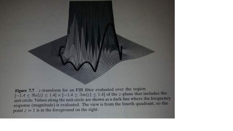

Does anyone know how I might go about graphing the Z-Transform in 3D? It want it to look something like the picture below.

Are you interested in knowing how to plot in 3D, or how to calculate the z transform? Do you have access to Symbolic Math Toolbox? If so, there are some helpful functions in it for doing z transforms. I don't think core MATLAB has a function for it but there is probably something on the file exchange. This may also be relevant:
http://www.mathworks.com/help/matlab/data_analysis/filtering-data.html#bqm3i7m-5
Otherwise, the plot you're looking at probably came from using meshgrid() and surf(), then overlaying the unit circle values with a call to plot3().
Likes 1 person
More so plotting in 3d, I've never used meshgrid or surf before. I do have access to the Symbolic Toolbox. Would I have to use BOTH meshgrid() and surf()?
