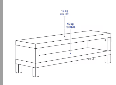

I wanted to put a 39-pound tv on this tv stand: https://www.ikea.com/us/en/p/lack-tv-unit-black-brown-00566060/
The weight limit of top shelf is 35 pounds, but my tv weighs at 39 pounds.
Is there any way I can adjust the force distribution so the shelf can hold my tv? tv has 2 base legs about 40 inches wide.

You can't really adjust the force distribution ( you could add material , but...) for what its worth the image is referring to a concentrated load of 35 lbf at the center of the span.
If your TV is like mine its on 4 legs situated just a few inches from each edge. So, it would be approximately this loading.
That's a favorable loading scenario in comparison.
Also, I don't know if I'm being dramatic, but I operate under the premise that the TV
weighs around 40 lbf. and the spec is for 35 lbf (they are using kgf instead of Newtons).

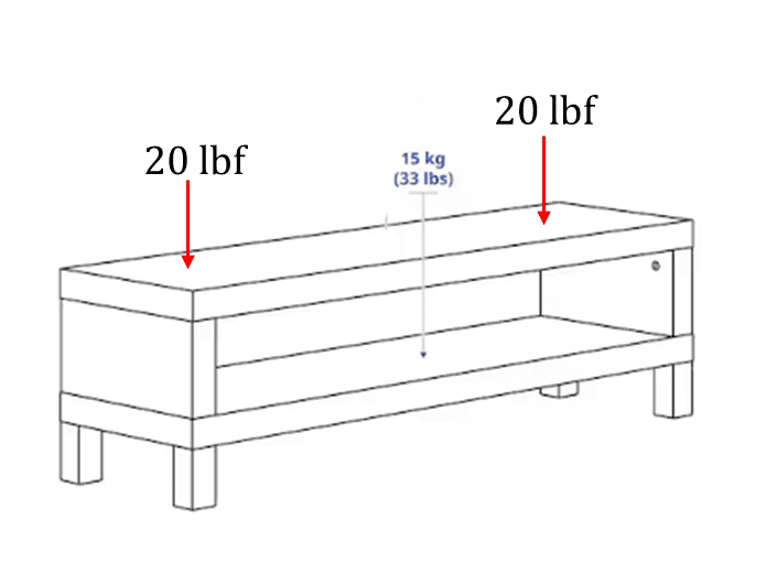

Thank you for the explanation. Yes, my tv will be like what's drawn in the second pic, about 20 lb each side (39 lb in total) but the total weight limit should be 35.
The point of application of loads are significant. Loading as the second diagram will result in less peak stress and deflection in comparison to a peak load as specified in the drawing. They should be specifying worst case loading in the drawing. Your TV is likely going to be supported near the ends of stand.

The legs and joints look stronger than needed, so it is safe to assume that the mode of failure will be progressive flexing of the top shelf.
From the moment point of view, 35 lb at the 1/2 way point, can be split into two point loads of 17.5 + 17.5 lb at the same 1/2 way central point.
If those point loads are separated, and brought back to the 1/4 and 3/4 way points, they will support 35 lb at each of those points, due to the lever arm advantage. That is sufficient to support a two legged 70 lb TV on the two separated points, since 70 lb / 2 = 35 lb.

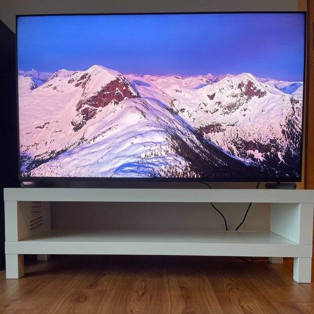

So here's how my tv stands. 4 pounds over the weight limit, so each tv leg has 2 pounds over the limit.
I may come back to update periodically how the stand is doing.
I suspect the stand will sag/bend eventually because time is another factor that I haven't considered.
Force × Time is more unpredictable. But let's see.
That looks like an ideal solution.
The TV legs are so close to the ends, that there will be no sagging.

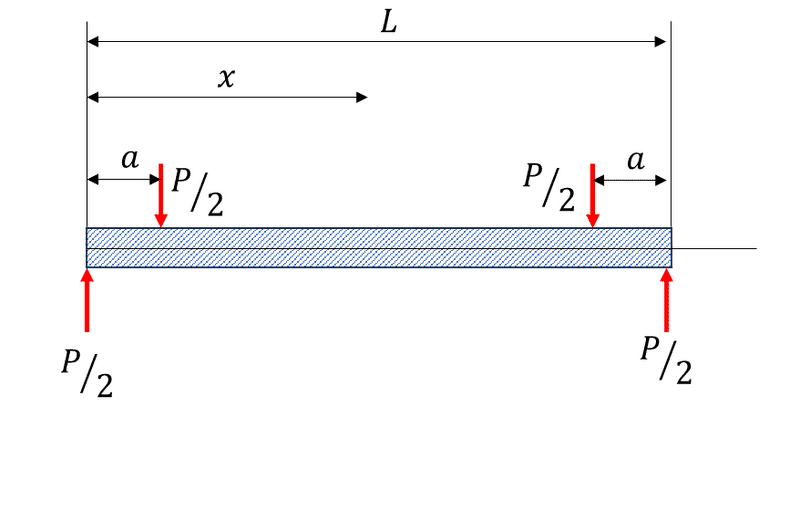

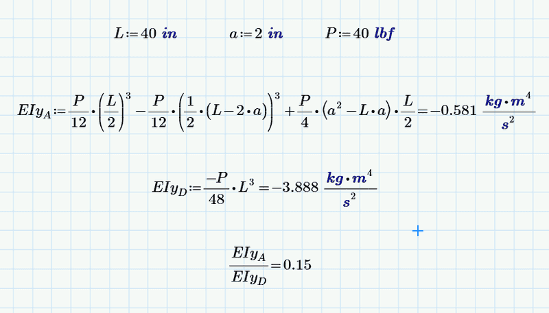

Just for the torture of it...Here is the approximate loading of the top shelf:
The elastic curve is given by:
$$ EI y(x) = \frac{P}{12} x^3 - \frac{P}{12} \langle x- a \rangle^3 - \frac{P}{12}\langle x- ( L-a) \rangle^3 -\frac{Pa}{4}( L- a)x $$
You evaluate at ##L/2## for maximum deflection (symmetric loading)and compare with max deflection of simply supported beam center point load ( same load - commonly found in textbooks, etc...)##y_D = -\frac{P}{48 E I}L^3##
You will find that your peak deflection ##y_A## is at about 15% of design maximum deflection of the design loading.
feel free to measure the distances of ##a## if you see the need and re-evaluate.
The angle braces ##\langle \rangle## are the Singularity Function ( that is zero for negative value and itself for positive values ).
