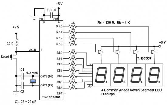

I want to make an LED display that can show 3 digits, so I have 7 segments for each digit for a total of 7x3=21 LEDs. I need this to display some data from a sensor I'm capturing with an Arduino, and I want to use the same Arduino to run the display.
How can I do this without flickering the LEDs? The only way I could think of is to use 7 digital pins to display the digits 1 by 1 and just cycle through them very quickly. The problem is that this means the LEDs are off 2/3 of the time, and also they have to flicker which can't be good for the LEDs and the eyes (I'm speculating).
Maybe there is some trick you can do, but I'm not familiar with electronics and I've thought about this for 4 days doing all sorts of designs with transistors and the bottom line is that I can't do it, it's like the hardest riddle ever.
Any ideas?

What problem? Google suggests that the normal way to do this is by multiplexing groups of LEDs tied together in common anode/cathode configurations. You'll need 10 pins on your uC.
Source: http://embedded-lab.com/blog/?p=2086

Not sure what is wrong with the picture in post 3. Very simple, common example of what the OP was referring to. That is one way it is commonly done. The ONLY reason to go to serial drivers or other external components is because you need the pins for something else or have more complex drive requirements. But whatever one decides regarding IO, sequencing the digits in such a way is the way nearly every multi digit 7 segment LED display works.

I agree about the suggested circuit. My problem was that you implied that a 3:1 reduction was necessary because of some speed capacity limitation. It's obvious that you need to put out information for three displays at three times the rate for one display but that doesn't mean you have to do it slower in this case. When it does become a problem, you just off-load that process to other circuitry. I probably misread your original meaning.
I was saying that you need to switch at least at that rate or else it would flicker. I've read that some people can sense 200Hz flicker in their peripheral vision (anecdotal).
