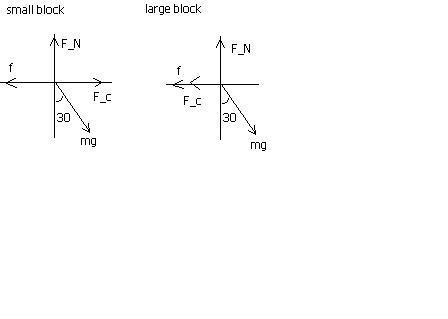

Look at the attachment it has the two diagrams I drew. I can't seem to put together an equation for it. I haven't done a whole lot of these problems before.

The attachment probably won't be cleared for hours, if history is any guide.
We'll look at each force in turn and how it acts on each block.
1) The weight forces, Mg and mg, are straight down, so what angle do they make to the incline? What is the component of weight that is perpendicular to the incline? parallel to the incline?
2) The normal force for each block points perpendicular to the incline, so it has no direct influence on the sliding of the blocks. But it is equal in magnitude to the perpendicular component of the weight, and we'll need that in order to find
3) the kinetic friction forces, which are parallel to the incline (since they oppose the motion of the blocks, which way do they point?). What is the relation of kinetic friction, f_k , to the normal force?
4) The contact force between the blocks is equal and opposite on each block (by Newton's Third Law). As we've said, the contact force on each block is parallel to the incline.
So the forces on each block parallel to the incline are:
1) the parallel-to-incline component of the weight of the block;
2) the kinetic friction ; and
3) the contact force.
The sum of these on each block gives the net force parallel to the incline, which will tell us something about the acceleration of each block (which is the same for both).
That's the set-up for the two equations.
The angle would be 30 degrees? Perpendicular would be sine? Parallel would be cosine?
The weight force (gravity) points straight downward. The incline is tilted 30 degrees to the horizontal. So the angle between the weight forces and the incline surface is...?
As for which trig function goes with which component, keep in mind that sine goes with the component "opposite" that angle, and cosine goes with the "adjacent" component.
