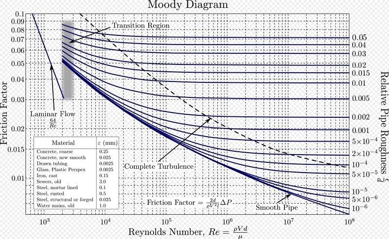

The best way to calculate pressure drop through long pipes is by using the Moody chart (search the term). This Moody chart is from the Wikipedia article:
You can check your calculations by comparing to the following page from Cameron Hydraulic Data, 16th Edition:
Note that head loss is typically expressed as feet of head per 100 feet of pipe. One foot of head is the pressure from a column of liquid one foot high. Multiply feet of head by density in lbs/ft^3 to get pressure in lbs per ft^2.
It's a very important calculation to get right in OTEC (search the term) conceptual calculations.

For the calculation I will assume a friction factor of .01. (The actual friction factor is slightly lower, which we will calculate at the end. We are overestimating friction by ~30pc, to leave some headroom)
$$ f = .01$$
The head loss per unit length is given by the formula
$$\frac{\Delta p}{L} = \frac{f \rho v^2}{2 d} $$
We assume the engine works at efficiency at peak power.( ## T_h = 95 ## and ## T_c = 5 ##)
$$ \eta = 1- \sqrt{\frac{T_c}{T_h}} = .131$$
The potential to do work per Kg of water is ( c = specific heat of water )
$$ w = c \eta \Delta T = 49300 J/Kg$$
A fraction of the energy ##p_f = .2 ## is used for pumping. We assume pumping efficiency is 75 pc. In one cycle work can be extracted twice from the same mass, one at the pole when cooling, and another at the equator when heating, we will assume it is identical. (## h_{head} = \frac{p_f w}{g} ##, L = 10000 Km} )
$$ \frac{\Delta p}{L} = .75 \frac{p g h_{head} }{L} = .739 pascal/m $$
mass flow rate M to generate 1 Terawatt of power is ## M = \frac{10^{12}}{w (1-p_f)} = 2.5 \times 10^7 kg/s## and Volume flow rate ##Q = \frac{M}{\rho} = 25\times 10^3 m^3/s##
The formula $$\frac{\Delta p}{L} = \frac{f \rho v^2}{2 d} = \frac{ 8 f \rho Q^2 }{\pi^2 d^5}$$ can be inverted to get the diameter
$$d = \sqrt[5]{\frac{ 8 f Q^2 \rho }{ \pi^2 (\Delta P/L) } } = 93 m$$
velocity of flow is ## v= \frac{Q}{\pi d^2} = .92 m/s ##
We use Colebrook-White equation iteratively to estimate the friction factor for these flow parameters, with surface roughness ##e = .25 mm ## and reynolds number ##Re = 3.9 \times 10^8##. We get ##f = 0.0067 ## In principle the calculation can iterated over, and if that is done we get ##d = 86m##. But some head room may be useful.
