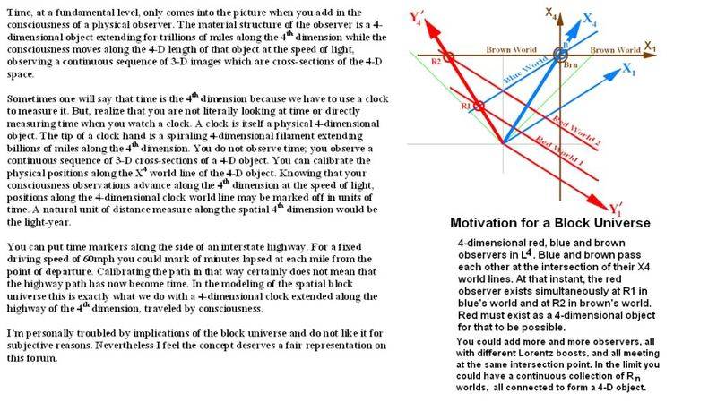

First, the 4th spatial dimension is implied by considerations depicted in the side sketches of my post. The fact that special relativity describes a situation in which different observers "live in different planes of simultaneity", each one including different cross-sections of 4-D objects, implies a spatial 4th dimension. Beyond that, we actually have views of the 4th dimension in this sense: We experience a sequence of cross-sections of the 4th dimension. If you merge those cross-sections together you have the 4-dimensional picture. So, the 4th dimension is as real as our normal X1, X2, and X3. (I'm avoiding any discussion of philosopher's viewpoints that deny the existence of an external reality.)
As you travel a 1000 mile interstate cross country you experience a piece of it at a time. You have no problem understanding that the whole stretch of interstate actually exists "out there", even though you cannot see it all at once. After traveling it, you can merge the whole path together to form the mental picture of the highway as it stretched for 1000 miles.
Remembering the continuous historical past sequence of experienced 3-D images, you can merge them together to get a kind of 4-dimensional image in your mind. However, the brain does not seem to be equiped with the tools for actually visualizing a 4-dimensional object. This makes your question difficult to deal with.
You say that I am moving through the fourth dimension at the speed of light. I certainly don't feel like I'm moving at the speed of light through any dimension.
It's kind of like watching a movie. You are caught up in the continuous evolving of the succesion of movie scenes without any thought of a long strip of movie film moving through the projector. We would have a more direct analogy of course if the movie film were strung out in space along a straight line and you were doing the moving along the length of the strip watching that same movie, experiencing the same movie-going experience without any thought of your motion through space.
So, a bundle of 4-dimensional neurons is analogous to the long strip of movie film. But, the neurons extend for billions or trillions of miles along ones 4-dimensional world line with consciousness flying along at the speed of light watching the movie.

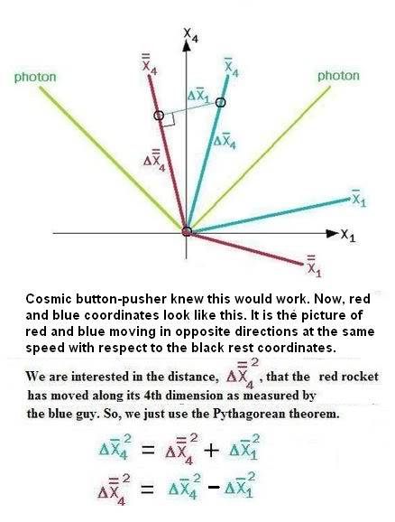

I've drawn on Paul Davies's cosmic button-pusher to present a fanciful example that may get across the point I've been trying to make. I'm not offering this as a proof for the spatial 4th dimension, but rather, hopefully, a clarification of the concept.

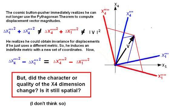

I see two questions regarding this:
(1) The cosmic button-pusher starts out by setting up a Euclidean space with a positive definite metric. Then, somehow, the mere act of granting consciousness to the blue observer changes the metric. How does that happen? Of course we know what the actual metric of spacetime is, so we know in advance what the answer is supposed to be, but how does that answer arise logically, within the scenario, as a result of granting the blue observer consciousness? I don't see any logical connection there. Put another way, since we already know that the metric of spacetime is not positive definite, your introduction of a hypothetical Euclidean space whose metric magically gets changed when an observer is granted consciousness is superfluous; it can be eliminated without changing anything else.
(2) You've used something like the second picture before in another thread, and I pointed out an issue there which, IIRC, you never responded to. Yes, for the particular set of values you chose, you can write down a "Pythagorean theorem" that appears to apply, but it only applies to particularly chosen sets of values; it does not apply generally. For example, draw a similar right triangle with sides blue X1, blue X4, and red X1 (instead of red X4); in other words, drop a perpendicular from the blue X1 axis to the red X1 axis (instead of from the blue X4 axis to the red X4 axis). You can still write down a "Pythagorean-style" equation: (red X1)^2 = (blue X1)^2 - (blue X4)^2. The problem is, now the LHS is a *side* of the right triangle, *not* the hypotenuse! So the cosmic button-pusher has *not* restored a Euclidean metric; he has merely picked out a particular set of values that can be rearranged in a certain way.

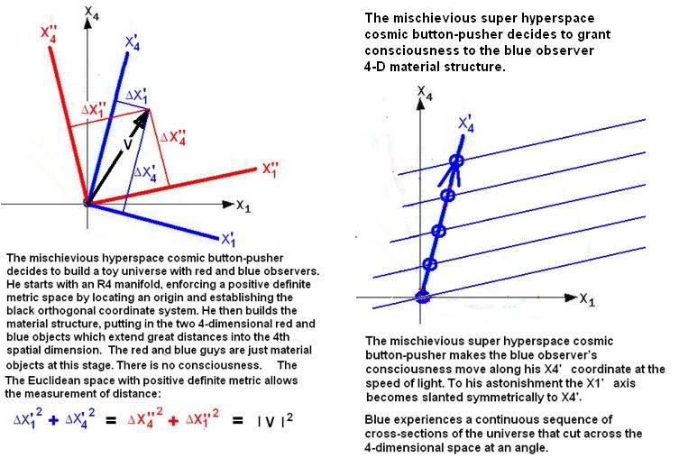

I knew I was not giving an accounting of how the slanted X1' pops out. Just didn't want to make the post so long and involved. The other part of the story would involve the cosmic guy's apprentice. Before adding in the consciousness the cosmic guy tells the apprentice to add in some other 4-dimensional objects to the positive definite manifold, then cosmic guy walks away leaving the apprentice to play with the toy universe. But, the apprentice is actually quite ingenious and puts objects in with very special orientations. He has developed an elaborate set of rules about how all of the objects should be arranged on the positive definite manifold.
To picture the kinds of geometric patterns the apprentice used in placing the objects, just think things like Feynman diagrams, processes involving conservation laws, etc.
Thus, when the consciousness is turned on and sent on a trip along the blue guy's world line, the only way the consciousness could acquire any comprehension of the continuous sequence of 3-D cross-section views of the 4-dimensional manifold with embedded objects would be to psychologically adjust his X1 cross-section view so as to be in sync with a Lorentz boosted view of the universe. That's just because the apprentice formed the patterns in just the right way to produce the unique invariances that are normally associated with Lorentz boosts. If the blue guy did not view the universe across a Lorentz boost view there would not be the kind of correlation in the sequence of events unfolding around him that could produce a comprehensible experience. It's kind of analogous to the difference between listening to random noise and music. If you are in an environment of a loud audible random noise, yet there is a lone violin playing a melody somewhere in the background, your brain has a way of filtering the violin melody so that you comprehend the sound in spite of the noise. The symmetry of geometric patterns present in the 4-D spatial universe makes possible some kind of correlation within the brain that plays some kind of role in the ability of the consciousness to recognize and comrehend. For the blue guy it was a matter of psychologically adjusting his cross-section view to the proper Lorentz boost that makes for an intelligible continuous sequence.
The cosmic button-pusher initially did not realize what his apprentice had done, but he quickly discovered the benefit of switching to a new metric so he could recognize the invariances and appreciate the local physics that resulted. He was quick to realize why the blue guy's consciousness automatically began scanning 4-D space in the slanted X1' direction. But, it is important to note that it was not necessary for the cosmic button-pusher to change metrics for his bird's eye view of the universe. The cosmic button-pusher could happily muse over the varied patterns of objects placed on the positive definite metric space. He just wouldn't see the physics that the apprentice had built into the patterns--which are only apparent if you change the metric so as to recognize the invariances associated with the Lorentz boost. Arranging objects does not change the intrinsic mathematical properties of the manifold--it's topology, etc.
The whole point of the story is to try to explain in what sense you can start with a positive definite manifold, yet then orient objects in a way that leads to the selection of an indefinite metric to make the orientation of objects intelligible. The quality of the four spatial dimensions did not change at all in that process. And there was certainly no rationale for regarding the 4th dimension as "time."
I don't agree with that. You give me any pair of observers moving relative to each other at any speed you wish. There is always a rest frame for which both observers are moving in opposite directions at the same speed. So, a symmetric space-time diagram can always be found that works in general for any pair of observers. And for example the Lorentz time dilation equation may be derived directly from the Pythagorean Theorem.
And yes, you're right; it's the differential geometry and associated mathematical machinery. However, all through the physics Master's and PhD curriculum, in all of the functional analysis, tensor analysis, group theory, set theory, QM courses, classical field theory, special relativity, general relativity, and cosmology courses, none of my professors ever discussed manifolds in this context. I tried only two or three times to discuss this with my doctoral relativity advisor, but he was quite annoyed that I would allow myself to get so distracted from doing real physics. And he was right in terms of how I should have spent my time in that phase of education.

In which case the manifold is no longer positive definite. Put another way, your claim that the manifold started out positive definite is not justified: "positive definite" is supposed to describe the actual physical metric that describes actual physical intervals, not an unobservable starting point that you then throw away and that plays no part in predicting any actual measurements.
As dimensions in a topological manifold, no. As dimensions in a metrical space, yes, X4 *did* change; you started out saying the metric was positive definite but as soon as any actual physical measurements were made it changed to non positive definite. You can't just handwave away that change in metric structure.
For *that particular pair of observers*, in *that particular frame*. A real metric is not like that; it gives the right answer for *all* pairs of observers, in any frame and any state of motion, without any special setup required each time.

Correct. But the whole point is that the quality of the X4 did not change. The apprentice simply added objects to the space without changing the fundamental quality of the space--it remains characterized as four spatial dimensions.

Wait. The cosmic button-pusher established a displacement vector, V, and established its magnitude as invariant with respect to both orthogonal coordinates using the positive definite metric.

Of course the measure of X4 changed with the selection of a new metric that could account for the kinds of symmetries present in the new geometry associated with the objects added into the space by the apprentice. But the whole point is that the character of the space itself did not change. We started with four spatial dimensions and did nothing to change the spatial character of the 4th dimension. Now, if we could not rely on a one-to-one mapping, then things might be different.
I didn't say that the derived equation was a derivation of the metric (you boxed me in on that one once before--good job, too). I just said that the cosmic button-pusher knew that he had the right form for the metric after checking that result. After all, he knew that he had reciprocal coordinate systems, i.e., the red was the dual of the blue. He understood the implications of the contravariant-covariant relationship that was manifest. And that observation was the inspiration for the apprentice's choice of rules for positioning the new objects--he wanted to utilize the metric,
And as soon as the metric is changed to respect the Lorentz symmetry instead of the Euclidean symmetry, it is impossible to maintain those supposedly established magnitudes for all displacements. You can, by carefully choosing only certain displacements, make it seem as though the magnitude is invariant for those particular displacements. But there's no way to do it for *all* displacements. It's not possible; it would amount to equating a positive definite metric with a non positive definite metric. It can't be done. So your claim that X4 remains a "spatial" dimension when the metric changes simply can't be sustained.
No. That has never been my point. I've not implied that you can have the same measurement of distance going from one metric to another. All you have to do is to start with the Lorentz transformations, compute the products, and there's no way the physical distances from one point to another come out the same.
