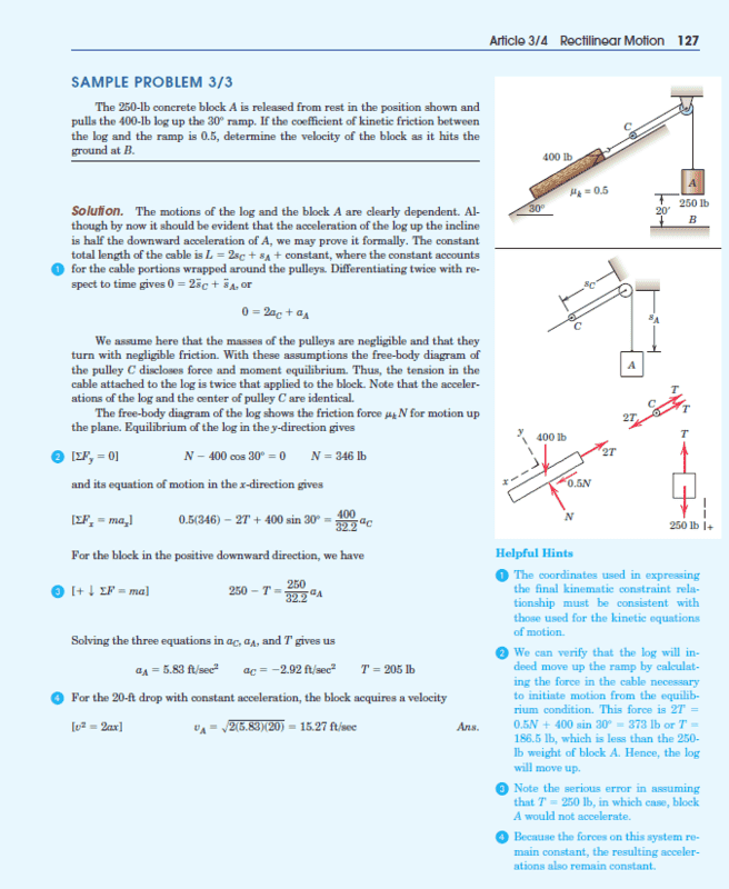

this is the question and solution given in the book

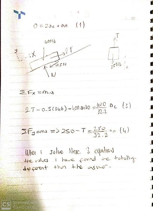

solution i made below. only difference is i took x as opposite side that given in the book and wrote F=ma equation that way. as a result the left side of equation (3) directly turned negative. that caused difference in result but why? i mean instinctly in these kind of questions i am tend to put positive axis towards sense of movement. can you please help me?

You will need to show us what you did for us to see where you are going wrong.

i also post what have i done at the end of my post. i did not understand what else do you need? i know solution is much easier with the energy but i am trying to get concept.
First, I can't read what you've written. Second, you say "when I solve these three equations I get a totally different answer". That could be for anyone of a hundred reasons.

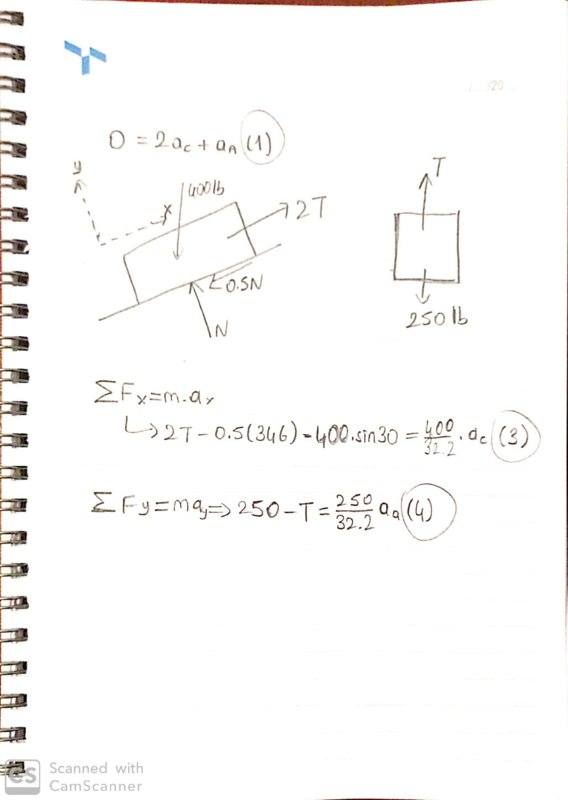

here is clear version i have equation (1) (3) and (4) just as in the book.

You need to change equation (1) if you have the accelerations both positive. The others look okay, although I'm not used to pounds and feet. Maybe equation (1) is your problem.
Just one observation. The book solution, I think, is not very good. It's very easy to mistype things when it's just a lot of numbers. But, if that's the way the book does things, who am I to argue?
