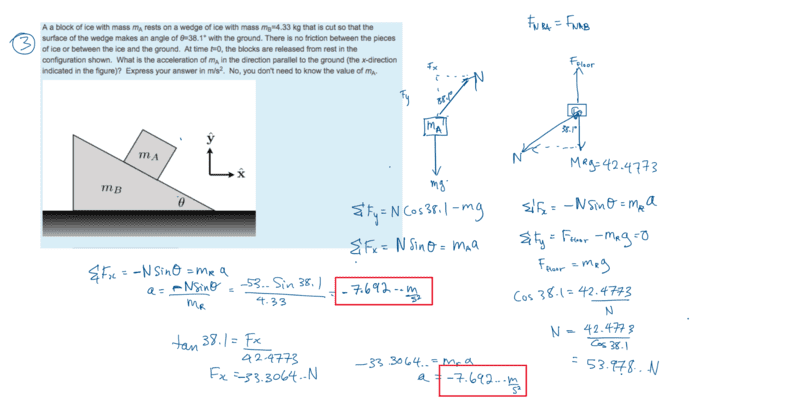

A a block of ice with mass mA rests on a wedge of ice with mass mB=4.33 kg that is cut so that the surface of the wedge makes an angle of θ=38.1° with the ground. There is no friction between the pieces of ice or between the ice and the ground. At time t=0, the blocks are released from rest in the configuration shown. What is the acceleration of mA in the direction parallel to the ground (the x-direction indicated in the figure)? Express your answer in m/s2. No, you don't need to know the value of mA.

I would guess you need to calculate the horizontal acceleration of Mass a if it were on a stationary wedge. Then calculate the acceleration of B (based on equal but opposite horizontal force) and add the two. But perhaps I need to see that diagram first!

I am just confused as this question uses a different coordinate system than I am used to:
I worked out the answer to be -7.69m/s2
but I am not sure if the negative acceleration makes sense

This is the link to my solution set so far. I found it hard to communicate without showing my freebody diagram: https://drive.google.com/open?id=1rwSUy2l8RXOEdg4HPofT-AkZ22r_U_jP

Which direction you suppose the mass ##m_A## will move?
You didn't take into account all forces in the ##y##-direction of the mass ##m_B## (wedge) - there is only the weight of the wedge and the reaction force of the floor. What about the normal force of the mass ##m_A## acting on the wedge?

I think the massA would move rightwards.
Actually, I have included the normal force and it is denoted N on my diagram.
I think that's good intuition. That problem looks easier than it is, only applying Newton's 2nd law will not be sufficient to solve it.

In the the schematic, yes (although there seems to be a mistake as far as I understand it). But the equation should read
$$\sum F_y = 0 = F_{Floor}-m_B\;g-N\;cos\theta $$

How do I solve for that when I am not given mass of block A. Also, based on the diagram that I have drawn the Normal force would be mg/Cosθ
neilparker62 said:
So your normal force should just be mgcosθ.
I assume you are referring to the normal force between block and wedge.
That would mean the block has no acceleration normal to the slope of the wedge, but since the wedge moves that will not be the case.

You have been inconsistent with the sign of the acceleration a. In one place you have N sin(θ)=mAa, in another it is -mAa.
As others have noted, finding the normal force is nontrivial. Instead, you need an equation relating the three accelerations and representing the fact that the block remains on the surface of the wedge.

So would normal force be N=mgCosθ?
I showed that was wrong in post #15.
Stop trying to guess the normal force - you will not succeed - and follow the line I described at the end of post #18.
First, I would mark down the directions of the accelerations of the two objects along with the force diagram. As you said earlier, the ice block would move horizontally(with respect to the floor) so you can mark that off with an acceleration value quite easily(which would be an unknown in your equations). The acceleration of B is not so straightforward. It moves on the wedge, but this motion is relative to the wedge. So if you assume B moves on the surface of A with some acceleration, then you need to use relative acceleration equations to figure out it's acceleration relative to the floor. It is this acceleration value that you should use in the force equations. You've used ##a## as the unknown variable for acceleration in the solution you posted. In reality you need two different variables to account for the two accelerations of the two objects A and B. But you would already know the directions of these accelerations.
Next, you have the two reaction forces between A and B and between A and the floor. These two forces are again two variables you don't know. This runs up the tally of total unknowns in the system to 4. But you do have 4 equations you can write down(as you you already have). From there on the problem is solving 4 simultaneous equations for 4 unknowns. You actually only need to solve for the two accelerations.
As was stated earlier, you are not asked for the normal forces in the question, so just solving for the accelerations is really sufficient. But you can calculate the forces quite easily once you know the accelerations. While the reaction force between A and B would ##m_BgCos(\theta)## if A were forced to be stationary, since A is in motion, it would not be equal to that value in general.
