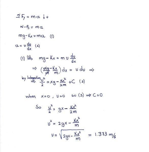

Hi! After reading a sample problem of the book I came up with the above solution.
I have a question though: If I integrate both sides of the equation just above equation (3)
shouldn't I be getting on both sides a constant C that cancels out?
  • Handwritten derivation: sum of forces in the downward direction gives mg - Kx = ma, then a = v dv/dx, leading to integration yielding v^2/2 = xg - Kx^2/2m + C, with C = 0 when x = 0 and v = 0, so v^2 = 2gx - Kx^2/m and v = sqrt(2gx - Kx^2/m) = 1.373 m/s.
Each side of the equation would have its own constant of integration. You can combine the two constants into one constant. Then, this constant is determined by the initial conditions as you have done.
Your work here is essentially the derivation of the work-energy principle for this particular problem.
