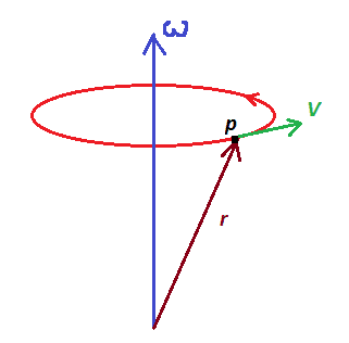

In Cartesian coordinaate system, we describe the rotation of a cylinder. The axis of the cylinder has the same direction as the basis vector e3. Angular velocity is described by vector w = 2e1 - 5e2 + 7e3 rad/s. I must find the velocity vector (v) of a point P that is described by position vector OP = 1e2 + 3e3.
I know the answer is just wXOP = (2,-5,7)X(0,1,3)=(-22,-6,2) and it's supposed to be an easy one. However, I can't quite imagine what is actually going on. I guess these are pretty stupid questions, but:
1) I know how the angular velocity vector is given. If the cylinder rotated around its axis, the angular velocity vector should be something like (0,0,x). Fine, cylinder don't have to rotate around its axis, but if so, doesn't the direction of the axis change and if so, what's the point of telling that its direction is e3?
2) A point on a cylinder would be moving so how can we describe it with a constant position vector? Or is it just a point "in space" through which the cylinder rotates?
3) In case like this on the picture
Diagram of a circular rotation: a horizontal circle with an arrow on it showing the sense of rotation, a red vertical arrow labelled omega at its centre marking the angular velocity axis, and a blue radial arrow labelled r pointing from the centre to the rim.
I understand that angular velocity X position vector (r) would give right answer, since v must be perpendicular with both w and r. Well, that is just what wXr gives us, but in given task, w and position vector OP are not perpendicular to each other. They do define a plane to witch v can be perpendicular, but ... well I just don't get what it means.
If someone could draw me a picture, it would be most helpful.
Yes, the axis of the cylinder will change orientation. The question is asking for the velocity of point P at the instant the axis of the cylinder is in the e3 direction.
The position of P is changing. But you just want to find its velocity at the instant when it is located at the given position.
I don't know if this picture will help. Each point P of the cylinder will have a velocity perpendicular to the plane formed by w and r. If w remains constant in magnitude and direction, then each point P will move in a circle around w. (I drew w vertical even though in your problem it tilts off in some direction.)
  • Vector diagram: blue arrow ω points straight up, red circle encloses it, point p on the circle with green arrow v tangent to the circle and dark red arrow r from the origin to p.
It's like the stars viewed from the surface of the Earth move in a circle about the axis of the Earth's rotation.
