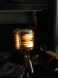

I am attempting to light LEDS off the phantom power of an amplifier/mixer.
traditionally the average mixer/amp used for DJ shows has a "Phantom Power" option. When activated it sends about 48v to each microphone...some mics need it...some don't...
I intend on using that 48v to power some LEDS...I have purchased some 12 volt LED clusters ( here is the link to the item ...http://www.oznium.com/super-bright-12v-led-module...) and was told to wire them in series to get all for to light using the 48v system...thus not needing resistors or any special circuits and for the most part it works..they all light...HOWEVER they all light dimmer then when I try to light each one from a 12v battery...Thus leading me to believe it is not a voltage problem but an amperage issue...I know nothing about electronics/ohms/amps/volts/or resistance
I do not have any other source to use to power these...I must get them to light up brighter with this being the only power source I can use...
I do not have specific details on how much amperage I am getting from the mixer ...I will hopefully get my hands on a multimeter and find that out as soon as I can figure out how to use one...
In the mean time ...is there a way to get these to light brighter...I have come so far with this project and I can't be defeated now...

yes I was trying to use the phantom power from the mic inputs to lite these clusters of LEDs... I have 3 other mics that someone else built which use 8 individual 5 mm LEDS and work but I was interested in making mine brighter and a more even illumination. I chose these clusters for their brightness and the abilty to wire them without worrying about using resistors... I guess I will just have to try to reverse engineer his design and go the individual LED way if there is no way to add anything that will increase the current. Thanks for all your research and I will be back when I get some different LEDs...I will need to know what resistors to use and how to wire them...your not off the hook yet...thanks again back to the drawing board
This is the one with 8 leds
[url]http://www.goldcoastkaraoke.com/mics/super55-side-lit.jpg[/url]
This is what mine would have looked like
http://www.goldcoastkaraoke.com/mics/image 3.jpg
