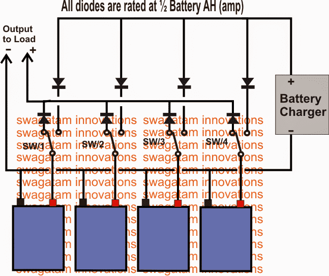

That's too mismatched to be useful. They need to be the same type and capacity, with the same charging history. You could potentially parallel same-voltage batteries if you diode-OR them, but then you are losing efficiency in the connection diodes...
https://homemade-circuits.com/wp-content/uploads/2014/07/batterychangeoverspdt.png
