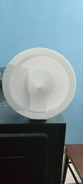

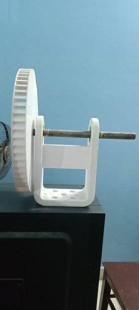

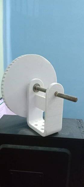

I recently have made a wind turbine and tested it (without any dynamo/alternator attached) and found the RPM to be around 360. What to know from others how my turbine has performed.
I recently have made a wind turbine based on Michael Waters basic design. It has 25 cm diameter and two bearings are attached to the shaft. At first, I have tested by putting it at the top of a ball point pen under a ceiling fan. You can see how it rotated in this video. But when I added the shaft and attached two bearings to it, the RPM reduced drastically in the same condition. You can check that from the second video. I now have tested it by putting it before a table that can generate around 6 m/s wind velocity and found the RPM to be around 360. You can check that from the third video. I am sure that with better bearings, the RPM can be much higher. Still I want to know how it has performed from others.

Then can you provide some photos for us? It will help tremendously if we can see what you are working with.
After all, a picture is worth a thousand words.

T C said:
Thank you for the pictures.
I suspect that your assessment that better ball bearings will improve performance is spot on.
