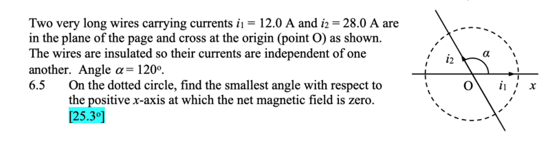

I liked problem 6.5 I have a similar one in my "booklet". The dotted circle is in the same plane as the wires I guess.
No hints. There are numerical answers highlighted in blue. All numbers are removed before a problem is placed on an exam. See comparison below. Yes, the plane of the circle is in the plane defined by the two wires.
In booklet
Physics problem: two long wires carrying i1 = 12.0 A and i2 = 28.0 A cross at origin O with angle 120°, and a dotted circle asks for the smallest angle on the positive x-axis where net magnetic field is zero; answer 25.3° highlighted.

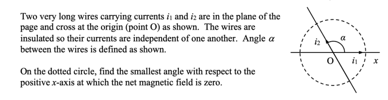

On test
Diagram of two long wires in the plane of the page crossing at origin O, with currents i1 along the positive x-axis and i2 on the other wire, angle alpha between them, and a dotted circle centered at O, with the problem text beside it.

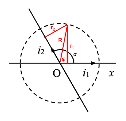

First I put down the step by step solution as I would write for a solutions manual. Then I would assign points for items that I would expect to be present. The exam would be accompanied with a formula sheet, so I did not give any points for copying formulas from the sheet onto the exam. In this case, putting down ##B=\frac{\mu_0}{2\pi r}## gets no points as would ##B=\frac{\mu_0}{2\pi r^2}.## I award points for what is there and correct. I do not subtract points for incorrect nonsense.
Solution (What I expect to see and how I would score it)
Strategy and justification
Let ##\varphi## be the unknown angle. The point of interest must be in the region ##0 < \varphi<\alpha## because that is where the field contributions are in opposite directions. For the field to be zero the contributions from each wire must have equal magnitudes and opposite directions. (1 point)
Diagram
Diagram showing the distances from the point of interest to each wire and angle ##\varphi## and identifying all symbols used in the solution. (2 points)
Diagram of two straight currents i1 and i2 through point O, with a dashed circle of radius R, distances r1 and r2 to a point on the circle, and angles phi and alpha marked.
Implementation of strategy
$$\dfrac{\mu_0i_1}{2\pi r_1}=\dfrac{\mu_0i_2}{2\pi r_2}\tag{1 point}$$ $$r_1=R\sin\varphi\tag{1 point}$$ $$r_2=R\sin(\alpha-\varphi)\tag{2 points}$$ $$\sin(\alpha-\varphi)=\sin\alpha \cos\varphi-\cos\alpha \sin\varphi \tag{1 point}$$ $$\mathrm{Consistent~algebra}\tag {1 point}$$
Answer $$\varphi = \arctan\left[\frac{i_2\sin\alpha}{i_1+i_2\cos\alpha}\right]\tag{1 point}$$

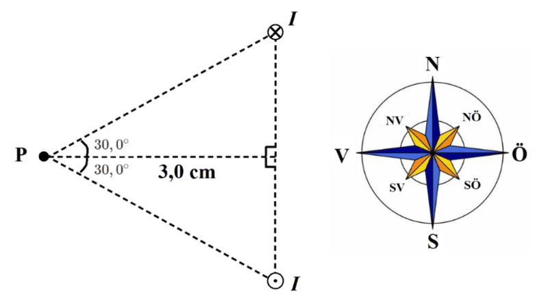

If this was a problem on one of my tests (remember, I work in Swedish high school) this would be an A-level problem with 3 points awarderd. Basically 1 point for that picture you draw with motivation, 1 point for the ##r_2 = R\sin(\alpha - \varphi)## and 1 point for correct answer.
For instance
On a place where the geomagnetic flux density is 53 μT and has angle of inclanation 72° the following experiment is conducted. Two straight wires are placed vertically against the ground. In these, an equally large 2,1 A current flows in directions as indicated in the figure. In a point P an horisontal compass-needle is placed. The figure depicts the experiment as viewed from above. At what angle and in what direction will the compass-needle point?
Diagram of two vertical wires viewed from above, each marked I with opposite current directions (into the page at top, out of the page at bottom), with point P on the left 3,0 cm away and 30,0° angles marked, next to a compass rose with N, NÖ, Ö, SÖ, S, SV, V, NV.
Answer: 37° as measured from the north to the western direction.
1 C-level point: determines the horisontal component of the geomagnetic flux density.
1 A-level point: correct setup for determining how the magnetic field from one of the two wiers will interact with the compass-needle in point P for instance by splittning it into one North-South component and one West-East component.
1 A-level point: correct determination of the total magnetic flux density at point P due to the two wires.
1 A-level point: correct answer with a clear written and structured solution.
