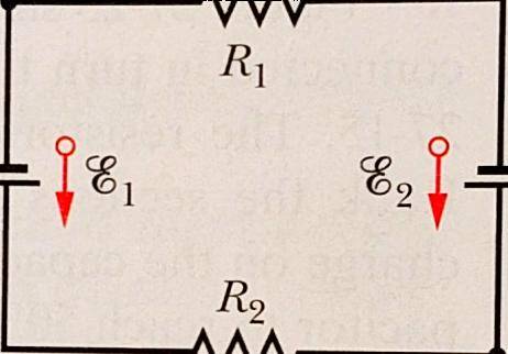

So, we are going into Kirchhoff's Laws in class, and my entire understanding of circuits, which took me a while to form, is again falling apart.
A physical understanding is absolutely essential to everything I do in physics, and I want to be as strict with it as I can while studying classical mechanics.
My new issue is with Kirchhoff's rules. I definitely understand the reasoning behind them, matter is conserved, as well as energy, so of course the junction rule describes matter, and the loop rule describes the conservation of energy through voltage. However, the instant I see this intuitive law in action, I fail to picture what is actually occurring on the atomic level.
To understand circuits, I had to learn electro-chemistry to try and understand the inner workings of a battery. I understand at this point that all batteries are effectively two separated electrodes, an anode and a cathode. By connecting the two together with a wire, their chemical composition (e.g, zinc vs copper) results in a redox reaction in which the atoms of the anode release their electrons into the wire, which travel around the new circuit, and on the way interact with various resistors.
One important point I inferred from this understanding is that electrons can NOT flow from the cathode to the anode (at least for commercial, non-rechargeable batteries).
Returning to the above circuit, let me quickly solve it so I have the reality of what is happening, and use it to describe my confusion.
Find the current through the circuit.
https://physicsforums-bernhardtmediall.netdna-ssl.com/data/attachments/97/97581-1aad8b8e3ec1d4ec37153371c25a5d91.jpg [If not visible, its attached below. Sorry, new to the forum :) ]
ε1 = 150 V ε2=50 V
R1 = 3 Ω R2 = 2 Ω
Using the loop rule, taking positive to be a counterclockwise current:
ε1 - ε2 - iR1 - iR2 = 0
Plugging in some numbers:
i = 20 A
Now, the reason why I am confused.
Initially, it makes sense that it should be a current in the clockwise direction, the first battery pushes harder than the second, which results in a net push. However, when looking at what is happening atomically, I become confused. Firstly, let's assume that these are fresh batteries, in which the cathode has had no time to accumulate significant negative charge from the reaction.
When a circuit is connected, there should be a potential difference supplied through a wire and resistor, etc. However, a battery consists of two completely separate electrodes, in which there is no means for an electron to flow in between the two ends apart from through the wire itself. So, when this particular circuit is connected, both batteries should have no "wire" to impart this potential, as they are cut off from a complete loop by another gap between electrodes.
I began to think that perhaps its the fact that there is a potential difference between the two negative ends of the batteries, resulting in a current anyway. But let me provide a counterexample which messed that up for me, using the above problem. Using the ground as a reference point, let's say the first battery's negative terminal is practically grounded (0 V potential difference to the ground), and the positive terminal has a very large positive charge relative to the ground. This results in a potential difference of 150 V between the negative and positive terminals of the first battery. The second battery once again has a grounded negative terminal, and a large positive charge on its positive terminal, resulting in a 50 V potential difference between the electrodes. Of course, this is not necessarily the way the battery actually is made, but it is a valid possibility. Once the above circuit is connected, there is no potential difference between the negative terminals, as they are both grounded, but there is a 100 V difference between the positive terminals. Electrons would be biased towards flowing towards the first battery's positive terminal as it has a higher voltage, and the wire connecting the positives would develop a current. As electrons flowed into the first battery's positive terminal, the voltage of that battery would decrease, as the difference in charge between the battery's electrodes decreased. The other battery would experience the opposite, gaining a little more voltage, as difference in charge increased. However, the relative potentials of the negative terminals to the ground would still remain zero, despite changing with respect to the positive terminals. As there are no new electrons being supplied by the imbalance on the positive terminals, it would quickly normalize to no current and no potential difference. By my logic, which must be flawed somewhere of course, this is not the correct theory for how the battery works.
Could someone please help me out here? I love thinking about this stuff, but circuits have thrown me into a world of solid state and quantum stuff which is a lot harder for me to know for sure I am on the right track.
Thanks in advance,
Shea

Just a small nitpick; it isn't about conservation of matter as you said here, but charge conservation. Probably a thinko, but just wanted to clarify that.
Shouldn't this translate to conservation of matter, since electrons are the carriers? (Ignoring the obviously important fact that they can technically be destroyed)

Scratch that! Looking through some engineering websites, batteries can't have reversed current, at least not realistically.
All the problems I'm attempting are using theoretical voltage sources, in which electrons can go either way without running into issues like the fact that its impossible in a real battery.
I always run into this issue with theoretical vs real explanations, like how voltage is constant in a wire, it made me believe that there should be no current, but in real life that is not true.
Thanks for the help guys!
Shealen Fairchild said:
.Looking through some engineering websites, batteries can't have reversed current, at least not realistically.
The current between the electrodes of a battery is carried by various ions, not by electrons, so you get a closed circuit and kcl is valid.
No, it is not.
Trying to understand circuit theory by thinking about electrons is a bit like trying to understand projectile motion by studying general relativity; it is simply not very helpful.
It is important to realize that the "real" physics behind transport through even something as simple as a metal conductor is extremely complicated; you need lots and lots of quantum mechanics and many-body physics, very few people ever reach the point where they "understand" what is going in detail (the only ones who do are theoretical physicists specializing in condensed matter theory). Fortunately, most of us do not need to understand things in that much detail.
There are only a few systems (that are hard to make) where you can think of a current as electrons traveling like small "ball" and even then you need at least some basic quantum mechanics (the electrons behave like wavepackets). There is no simple "physical" model that works in the general case.
At the level you are at it is usually best to use Kirchhoff's laws as a "given". Once you've understand how they are used you can move on to Maxwell's equations; and once you've understood those you can move on to quantum mechanics and condensed matter theory :smile:

where you are learning to apply laws of Kirchoff and Ohm
it is quite helpful to treat circuits as if they were pipes carrying the mysterious fluid "Electric Charge"
and since metal wires are effectively atoms awash in a sea of loosely bound electrons, which indeed transport the charge,
(and i'll probably get hammered for this,)
for purposes of analyzing circuits it is fair to say that pushing an electron in one end of a wire causes one to be pushed out the other end.
That causes trouble when not used carefully because it leads people to oversimplifications.
Careless instructors do not point out that there is a time delay between the electron entering one end and an electron exiting the other, so students assume it's instantaneous.
Absolutely not so.
It's not instantaneous. It proceeds at a speed determined by the characteristics of the wire, mostly its insulation, and is usually something like 2/3 c(speed of light) . So it's close to instantaneous and at beginner level we treat it as so.
That leads students to assume the electron raced down the wire at 2/3c .
Absolutely not so. If electrons move even a cm/sec the wire will melt.
It's more akin to pushing marbles through a tube that's already full of them. The marble you push in one end pushes all of them along, and the one that pops out the far end is not the same marble. That one was pushed in a long time ago.
Whatever Charge is, it progresses along the line of marbles(or electrons) like gossip , way faster than the carriers themselves are moving.
If you adhere rigorously to those concepts you can go a long way in basic "How Things Work" circuit analysis and avoid the pitfalls of "Electrons whizzing around circuits".
It then becomes useful to imagine yourself very small and walking along inside the circuit , writing down terms for your KVL equation as you encounter them..
And imagining ourselves small has the side benefit it keeps us humble.
Seems to me the exercise OP posted at beginning intends to teach the mechanics of using Kirchoff's laws to solve DC circuits and that's an absolutely necessary skill ..
Maxwell comes later.
