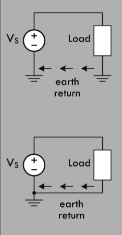

Is possible that the current flow to one negative terminal of another source(to closing the loop)?
Bingo, that's it. In the circuit below, no current flows out of the plus side of the battery unless an equal current flows into the minus side. At the grounding point d, the current c-d exactly matches the current d-a. In other words, add the ground, or remove the ground and nothing changes.

In some cases current can flow through soil. But they're rare, so it is best to not let them spoil your ideas about closed circuits. Look at the diagram in post #4 and imagine that ground symbol to be the chassis.
To the negative terminal through the soil chassis.
The negative terminal is also connected to the chassis.

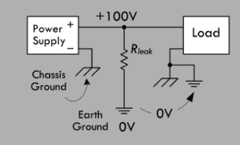

OK, and if I have this circuit:
The point where +100V is written is connected to ground, so it is at 0V...(?), also the return is at 0V because it is connected to the ground... how the current flow if there is not potential difference?
Not sure where you got this schematic but no the + line is not connected to ground , it is connected to ground through a resistor named "R leak" in the schematic.
That resistor can have any value but in reality for practical applications it would have a large value so a high resistance so very little current would flow through it , otherwise if the value was low you would "short circuit" the + line to ground because in this schematic following the symbols it seems that the power supply negative is connected to chassis ground which at the load side is connected to the real ground so if we drew connecting lines between those symbols they would all connect together at one point.
By that argument, any load connected across a battery would bring the terminal volts to zero. You made a wrong assumption that any load is a 'short'.

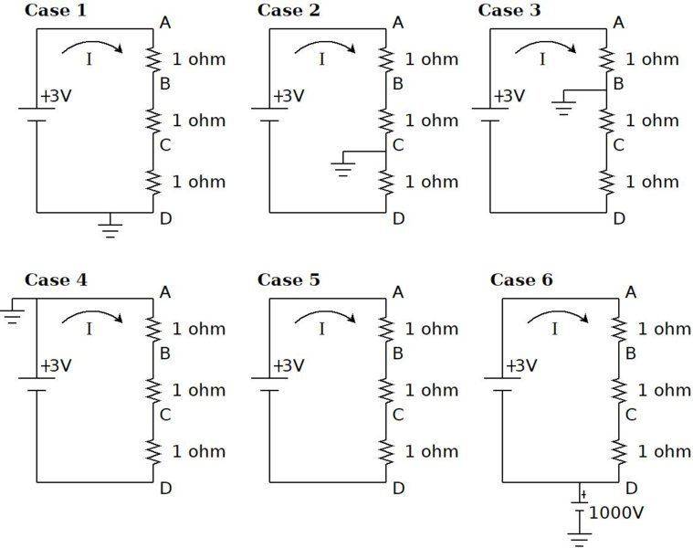

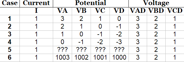

Try these 6 circuits. See what the current is in each. Note the voltages, and how they differ from absolute potentials. Voltages are always measured between two points. That may be what is confusing you.
