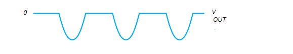

I think the potential across the load resistor will be the same but with an opposite sign
i mean that the voltage will take this shape ..am i right ??
Looks good!
