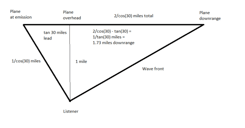

Like I said, a diagram is needed:
The sound pulses/waves travels radially out from the plane and are heard by the observer on the ground along a path perpendicular to the ground and direction of travel of the plane. So the sound from the plane traveled perpendicular to the direction of travel of the plane, from the plane at A to reach the observer at A1; At 300m/s (the speed of sound, rounded to the nearest hundred). In both cases.
In the first case, the plane is moving at 150 m/s and the point of arrival of the pulses also moves at 150 m/s. In the second case, 600 m/s.
I'll say it again:
1. The sound waves travel away from the plane at 300 m/s (speed of sound).
2. The point where the sound waves arrive at the ground moves at the speed of the plane.
  • #43

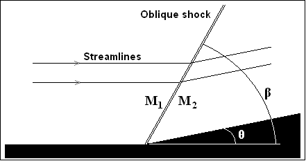

What would be helpful, is a non-local version of the graphic below, that shows what happens with the oblique shock with increasing distance. It should be based on a 3D object like a cone (the graphic being just a 2D cross section).
- Does the conical oblique shock maintain the same opening angle ##\beta## with increasing distance?
- Do the streamlines maintain the same turning angle ##\theta## with increasing distance?

In the near field, yes, the conical version of an oblique shock maintains the same opening angle ##\beta## with increasing distance from the tip. Assuming a cone of infinite length, it will continue to do so. For a finite length cone, there will be other waves generated that eventually intersect that shock and cause it to bend (typically a reduction in ##\beta##). I should also note that ##\beta_{\mathrm{wedge}}\neq\beta_{\mathrm{cone}}##. It's the far field I am less sure of. I am intuitively able to convince myself either way depending on the argument, so I need to do some digging on that one.

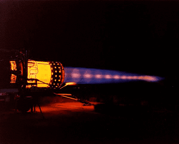

This rocket seems to be generating shocks and they only extend for just a few times its length. Could this be an indication as to the extent of actual shocks from a supersonic aircraft?
  • #57
That's a different physical mechanism, though, and one that would make a fun Insights article in its own right.
...including a relationship with the mach cone/angle.
  • #59
Standing wave?
  • #60
sophiecentaur said:
Standing wave?
Yes you can set up a standing wave that way. It happens frequently when doing static test stand fires of jet and rocket engines. You have a pressure leaving the nozzle that is different from atmospheric and requires a series of expansion and shock waves to allow it to come to equilibrium with the surroundings.
