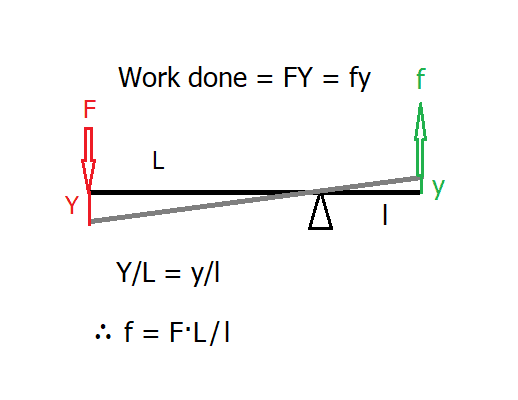

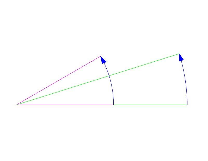

For the same length of arc along which a tangential force is applied (same input work), a longer lever produces less angle of rotation; therefore, more torque (same output work).
