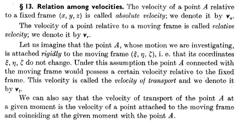

Assume we have two coordinate frames ##Oxyz, O'x'y'z'## the first one is fixed and the second one somehow moves, perhaps rotates. Then velocity of a point relative ##Oxyz## is
##\boldsymbol v=\boldsymbol v_r+\boldsymbol v_e,## where ##\boldsymbol v_r## is point's velocity relative ##O'x'y'z'.## The question is: how is referred to as the velocity ##\boldsymbol v_e##?

That is what I ask about. I understand the physical part of the formula, I just wonder what is the term ##\boldsymbol v_e## called in English.

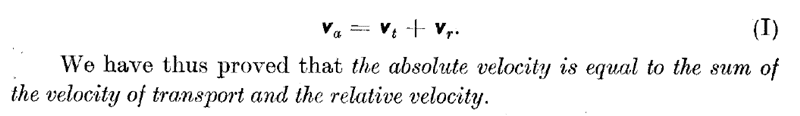

I have found the term at last! S. Banach: Mechanics, Warszawa, 1951. Translated in English by E J Scott.
By the way, in Banach's book the moving frame can move arbitrary.
