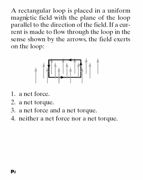

If the the rectangle is parallel to the magnetic field and we know that FB is perpendicular to the B field itself than there should be a net Torque but no net force. Is this assumption correct?
My first intuition was to say there was a net force and no net torque but I think that is wrong because magnetic force acts perpendicular to the magnetic field (B).
Yes, it is correct. Can you explain, why?
ehild
Yes because Magnetic Force = qv cross B thus it acts perpendicular to the magnetic field (B) since it is a cross product. The magnitude of the force is qvbsin(theta).
But then there can be a net force on the rectangle, perpendicular to it, is it right?
What is v in the formula?
ehild
there is a different formula (derived from the formula u wrote) used in case of currents ... do you know it?
I would consider the magnetic force on each segment of the loop and sum these.
correct way ! :approve:
