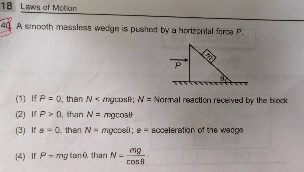

A smooth massless wedge is pushed by a horizontal Force P, then
(1) If P=0, than N<mgcos(theta); N=Normal reaction received by block
(2) If P>0, than N=mgcos(theta)
(3) If a=0, than N=mgcos(theta);a=acceleration of the wedge
(4)If P=mgtan(theta), than N=mg/cos(theta)
F=ma, Cpmponents of weight
245648
Answers- 1,3,4
My attempt, the wedge being massless, there shoul not be any force acting on as it will then have infinite acceleration, so by that i really can't think of how force is applied on pully.

Can you help, in first option N<mgcos(theta) but if there is even a little bit of Normal force on wedge that how can it be true(the option is correct) ?... If you can explain the 1,3,4 option then please help me
As Haruspex said, no net force. P is not the only force working on the block.
Can you describe what you think will happen when P = 0 ?

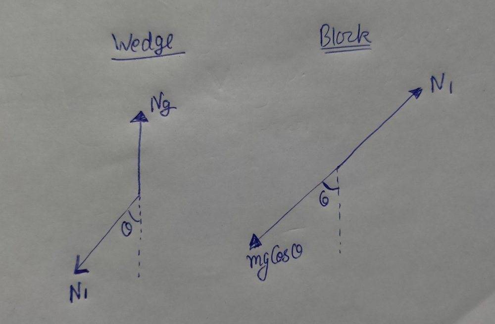

ok, it won't be, let me try drawing FBD.

What to do next I can't figure it out...
Shivam said:
View attachment 245688What to do next I can't figure it out...
Since you have now omitted P I assume you are thinking of (1).
The normal force between block and wedge might not be mg cos θ in this case.
For the net force on the wedge to be zero, what must the two normal forces on it be?

Let's think of this, even if N1 <mgCos(theta) then let's make it's components one will be in horizontal and one will be in vertical and the vertical component of N1 will be canceled by the Ng given by the ground, then what will cancel horizontal component. ?

(2.) Another thought of mine is, wedge is massless, so it doesn't even exist then the block should only move in downward direction with mg force then N1 should be equal to zero
Clearly, nothing.. so what do you deduce about the normal forces on the wedge when P=0?
That is correct... If P=0, there is no horizontal external force on the system, the centre of mass does not move in horizontal direction: but the wedge is massless, the centre of mass is in the block. The block moves down the slope, and the wedge moves to the left and that motion cancels the horizontal component of motion of the block along the wedge. No horizontal acceleration of the block, no force in that direction...
Yes, if P=0, but I took the prefix (2) in @Shivam 's post #13 as referring to case 2 in post #1.
