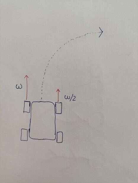

isni
This is not homework, it's a problem I came across while trying to model differential braking for my flight simulator. I cannot really see what force pushes the vehicle horizontally and I would really appreciate a detailed explaination.
If they are performing pure rolling, the velocity of COM of the wheels will be different that causes the curved trajectory.
what you say makes a lot of sense, but it doesn't explain what im mostly interested in, what forces are applied to the vehicle, as a whole, that makes it follow this curved trajectory. There has to be a horizontal force in there and I cannot figure out where it's coming from
You should have a friction force pointing towards the left at the front axle and another one pointing right at the rear axle. If the moments are in equilibrium, the vehicle will go forward. (Vertically in your drawing.)
If the sideway static friction forces of your wheels can be broken (sliding), your vehicle will rotate about the COM (or some other point if the moments of the sideway forces are not equal and opposite), changing the direction of your forces. So as the vehicle still seems to go "forward", the newly rotated vehicle's frame moves sideways with respect to the ground.

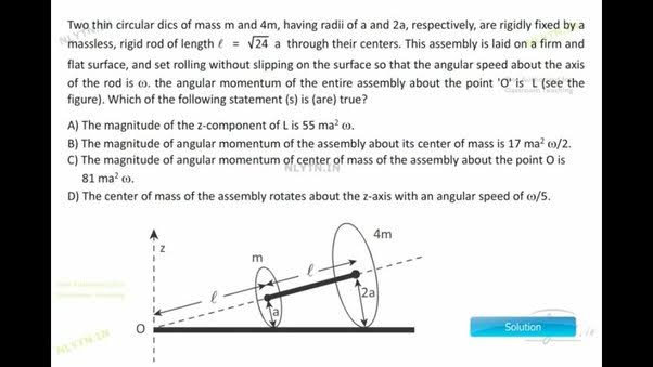

One easy arrangement would be a solid drive axle (no differential) attached rigidly to the wheels. One wheel with radius ##2r## on the left and one wheel with radius ##r## on the right.
Probably not a Michelin XGV size 75R-14.

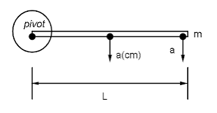

I thought if the velocity of COM of both the wheels is different, it can be treated as rod whose ends have different velocities causing the rod to rotate. It is analogous to that, Right?
Something similar to this except velocity(v) in place of acceleration and axis of rotation outside the both wheels
OR in this question:
Then tension is the internal force in the rod
"Cause"?
If the rod has ends that move at different velocities then the rod will be rotating. But that is correlation, not causation.
If the rod is "rigid" then it will retain its size and shape regardless of the pattern of external forces that is encountered. In practice, "rigid" means that small deformations result in large restoring stresses so that size and shape are approximately preserved.
Flight simulator dealing with 4-wheel vehicle? :oldconfused:
What is the driving force?
What makes the shown angular velocities different?
How the mentioned differential braking works in this specific case?
