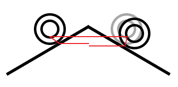

  • #107
Cool.
No, they will not roll.
The thread, the radii and the two touch-points of the wheels together form a trapezoid.
The first thing that rolling would theoretically result in is the lengthening of the longest side (the line between the two touch-points).
That trapezoid cannot be deformed and still maintain symmetry.
Not so sure now.

Well, it does depend on the relationship between the ratio of the radii and the angle of the slope. What if the slope increases to 60 degrees?

To elaborate, static equilibrium is maintained when the torque due to gravity and the torque due to the tension in the string are in opposite directions. The former is non-zero as long as ##\theta < 90^o##. The latter becomes zero when the radius of the inner wheel is large enough so that the position vector from the contact point to the point of application of the tension is horizontal. This happens when ##r/R=\cos\theta##. For ##r/R>\cos\theta## the two torques are in the same direction and there can be no equilibrium. Note: Torques are calculated using the point of contact of the wheel with the incline as origin.
  • #110
The distance between circle centres is the length of tight string.
It is not the change in height, Sin(30°), but the change in horizontal separation, Cos(30°) that is important.
They will not roll because R/2R = 0.5 string released, is less than Cos(30°) = 0.886 string required between centres.
Roll becomes possible when Cos(slope) = R/2R = 0.5 which will be when the slope becomes > 60°.

It boils down to whether to string goes above or below the contact points.

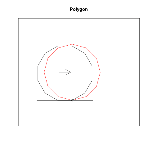

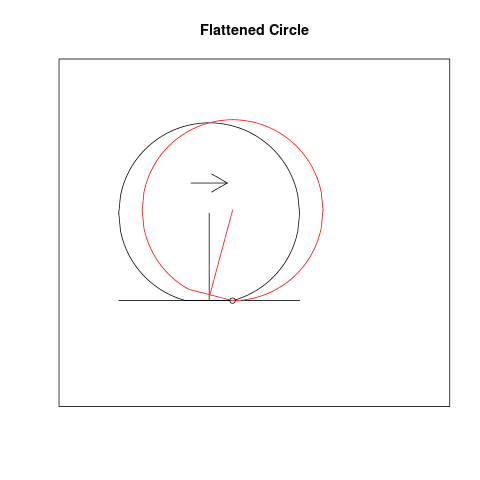

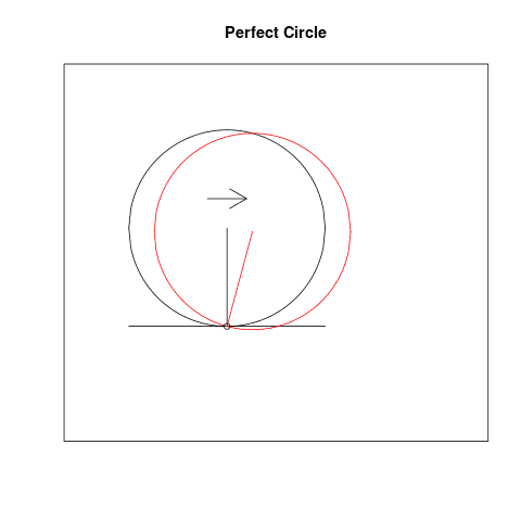

andrewkirk said:
I promised some pictures earlier, and I've finally made them. Here are three pictures, showing a wheel rotating around a point of contact with the ground. The first is a perfectly circular wheel, the second is a wheel with the bottom flattened (eg a tyre compressing under the weight of the load) and the third is a polygon.
We see that, if the wheel rotates around the foremost point of contact in the direction of travel (marked) through a non-zero angle, it all works OK for the polygon and the flattened wheel, but not for the perfect circle, which has to go below the floor.
The answer arrived at in the thread above is that there is no rotation through any angle about that point. Rather, the statement that the wheel is rotating about that point is just a description of the instantaneous relative velocities of points on the wheel.
View attachment 215189 View attachment 215190 View attachment 215191
You're right ... In a rigid body, you can't consider 2 simultaneous "centers of rotation" at the same time (so, a point from which all the other body points motion can be described as circles around that "point")... such body would be no rigid.
The only way you can describe the movement of the points of a wheel if the geometrical lowest point of the wheel is moving along a line, is as the composition of one translation movement that follows that "line", and one rotational movement around the center of the wheel. So, or that "center of rotation" is constantly flipping between the center of the wheel and the geometrical contact point (but never both at the same time), or there's no point in saying that the contact point has been the center of rotation at any time, even if an infinitesimal time is considered.
