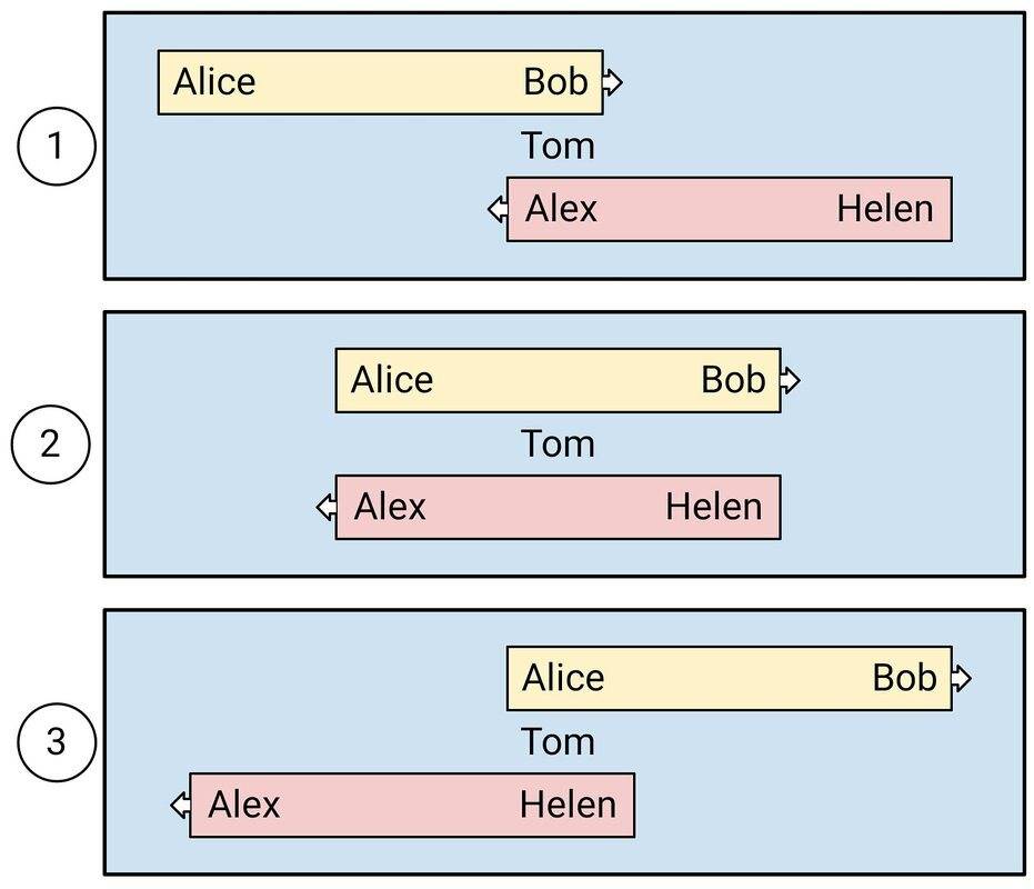

Is there any problem: All the answers claim that the photos show that Alex will be younger than Alice. But we can assume that there is a new person in Alex's reference system, whom we will name Helen (assume that Helen was present in the original experiment but was not declared). The distance that separates Alex from Eleni is equal to the distance that separates Bob from Alice. Alex and Helen clocks are synchronized with Einstein's method. When Alex stops where Alice is, Helen will stop where Bob is. In addition, Bob photographs his own clock and Helen's clock before Helen stops.
Based on the answers given, Bob's photos will show that Bob is younger than Helen. Therefore, photographs by Alex and Bob show that these two observers are still in sync. This fact is contradictory if we consider the relationships that connect the four photographed watches. However, I suspect the answer will be that the photos of Alex and Bob were not taken at the same time. But then a big problem arises: For Relativity to be consistent, the real age differences between Alex and Bob will depend on the following choices.
1. Alex slows down and stops near Alice.
2. Bob slows down and stops near Helen.
3. Bob and Alex both slow down in the same way to stop next to the girls.
So, since choices 1 and 2 mean that Alex and Bob do not stop at the same time, then choice 3 seems unfeasible, as the third choice ensures the synchronization of Alex and Bob's watches.

There are no contradictions involved, as long as you are careful to apply all the Relativistic effects correctly.
* This is one of those instances where you have really be careful if you try to assume instantaneous velocity changes, as they can introduce contradictions (contradictions that don't arise in reality, because you can't actually have instantaneous velocity changes.)[/QUOTE]
Before I start, @George Plousos, a quick warning: you've taken a fairly simple scenario, listened to our explanations, and added a new element to it, leading to more confusion. This is a fairly common pattern here (I call it "yes, but...") and tends to repeat - you add a complication, get an explanation, go "yes, but" and add another complication. It never ends well. The problem just gets messier without adding to your understanding, and we get frustrated repeating variants on the same thing (usually, "you don't seem to understand the relativity of simultaneity"). With that in mind, I strongly suggest that you study the maths, rather than adding more elements to your scenario - it's only yourself you are tripping up with the added complexity.
Let's look at the maths. Your original scenario was:
  • Bob, at rest.
  • Alice, at rest with respect to Bob, 10 light years distant as measured in their rest frame.
  • Alex, moving from Bob to Alice at 0.6c as measured by them.
And the question was what time does each person's watch read when Alex meets Alice?
The easiest frame to work in is Bob and Alice's rest frame, since most of the information is specified in that frame. What we need to write down is the position (call this ##x##) and time (call this ##t##) of every event of interest. Events of interest are:

I will study your notes, Ibix. In the meantime I have prepared this thought experiment:
I think I can show that the answer to the original question may be different. To achieve this I will use two additional people, Helen and Tom, but in the end I will remove these two people as if they never existed, so only Bob, Alice and Alex will remain on stage, as the original question wants. The image helps a lot.
Three numbered panels showing blue frames with yellow and pink bars labelled Alice, Bob, Alex, Helen and Tom, with arrows indicating direction of motion, at three different stages.
Fig 1: The distance that separates Bob from Alice in the yellow reference frame is the same as the distance that separates Alex from Helen in the pink reference frame. The clocks of the observers in each separate reference frame are synchronized with the Einstein method. Tom is considered immobile, while Bob and Alex move at the same speed in Tom's view. At the meeting point of the three boys, their three clocks are synchronized.
Fig 2: At some point along the way, Alex will meet Alice and they will be photographed with each other. At some point the same thing will happen between Bob and Helen. We will return to figure 2 later.
Fig 3: Tom meets Alice and Helen. Because of the symmetry, Alice and Helen's clocks remain synchronized in Tom's view. If you want, the two girls are photographed with each other. Immediately after this observation, Tom sees Alice and Eleni slowing down at the same speed and stopping. Obviously, in the short time between Tom's last observation and the immobilization of the girls, there is no dramatic change in their clocks, but this is true anyway because of the symmetry of the system with respect to Tom.
Now all observers are motionless with each other - they are in the same frame of reference. Alice is in sync with Bob and Helen, who is in sync with Alex. So Bob, Alice, Alex and Helen are all in sync with each other. But then all four observers must have been in sync at all stages of the journey between Figures 1 and 3. Consequently, in the events described above for Fig 2 these four observers would also be in sync. We can now forget the involvement of Helen and Tom in the experiment, to find that the same conclusions apply to the original question - we now refer to the facts of figure 2 without Helen and Tom.
The answer to the original question was that the photos between Alex and Alice would show that Alex's watch was going backwards relative to Alice's watch before Alex stopped, but based on the new arguments the same photos must show that their clocks have remained in sync.
I can not see any error in the above arguments, unless I am blind because of my prejudice, or I have not learned everything I should.
You haven’t.
Go back and read post #37 by @Ibix in this thread. Then follow the recipe he outlined there, writing down the coordinates assigned to each relevant event using one frame and then applying the Lorentz transformations to find the coordinates using the other frame.
It has already been pointed out that, if you don't have the basic scenario with just three people (Bob, Alice, and Alex) in it straight on its own, adding more people won't help, it will just confuse you.
I strongly suggest that you take a step back and really consider this advice.
You are playing the "yes, but..." game I mentioned in #37. As I said in that post, it confuses you, frustrates us, and you don't learn anything. Focus on applying the maths instead of verbal reasoning about ever more complex scenarios.
According to which frame? From what you say later, I assume you mean according to the frame in which Tom is considered at rest.
Prior Alex, Bob, Helen and Alice coming to a rest with respect to Tom, Alice and Bob would not say that their clocks were in sync. Neither would Alex and Helen say that their clocks were in sync.
So while Tom might say that all four of these clocks started in sync, started their deceleration at the same time, decelerated at the same rate, and thus remain in snyc the whole time, Non of the other observers would say the same. Alice, for example, would say that Bob's clock reads ahead of hers at the start. He will begin his "deceleration" before she does, and thus after that his clock will run slow compared to hers.
Then when she finally reaches Tom, and begins her "deceleration", the effects of being in an accelerated frame causes here to say that Bob's clock starts running even slower. By the time she comes to a rest with respect to Bob, she will say that both their clocks do read the same. But that does not mean that She and Bob agree that their clocks read the same during the whole exercise.
If we look at figure 2, it shows Alex and Alice lining up at the same time that Bob and Helen do. We also assume that all four clocks read the same time as this happens. But all this is according to Tom's rest frame.

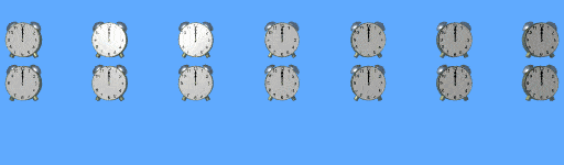

Here's an animation which is similar to what you are trying to do here:
We have two rows of clocks, in motion with respect to each other. We have arranged things, so that from the rest frame of the lower row of clocks, the clocks in the upper row are spaced the same distance apart as those in the bottom row, run at the same rate as those in the bottom row and are snychronized with the bottom rows clocks, and themselves. Thus, as each clock passes the one below it, they read the same time.
Two rows of seven grey analog alarm clocks on a blue background, each showing a different hand position; the top row is slightly offset from the bottom row.

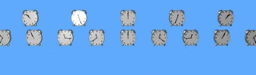

However, if we switch to being at rest with respect to the upper row, we see this:
Diagram of a row of alarm clocks at different positions and heights on a blue background, some clocks displaying different times on their hands.
The clock's in the lower row run slower than the upper row clocks, the distances, are different, and none of the clocks are in sync in either row.
However, every time a upper and lower row clock pass each other, they still read the same time.
Thus the two frames remain in agreement about what happens as any two clocks pass each other, they just don't agree on how this comes about.
