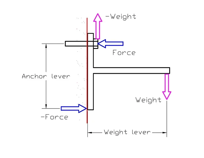

I am not sure what the system "as a whole is."
I am not sure either what @Lnewqban means by that, but it sounds like both bars + attached weight.

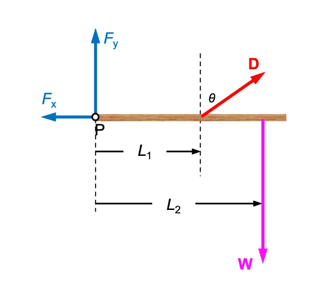

kuruman said:
To answer part (b) we choose our system to be the horizontal bar only.
Is the net couple zero in this system? The couple produced by the two forces in the x-direction is zero. However, it seems that the three forces in the y-direction do not cancel to give a zero couple.

I mean couple not moment. Thanks to #6 in usual case
Blue forces couple and red forces couple cancel. My #16 confirms it. In the calculation of forces for horizontal bar system shown, I do not find such couple cancellation. This net zero couple seems the point of the exam in OP.

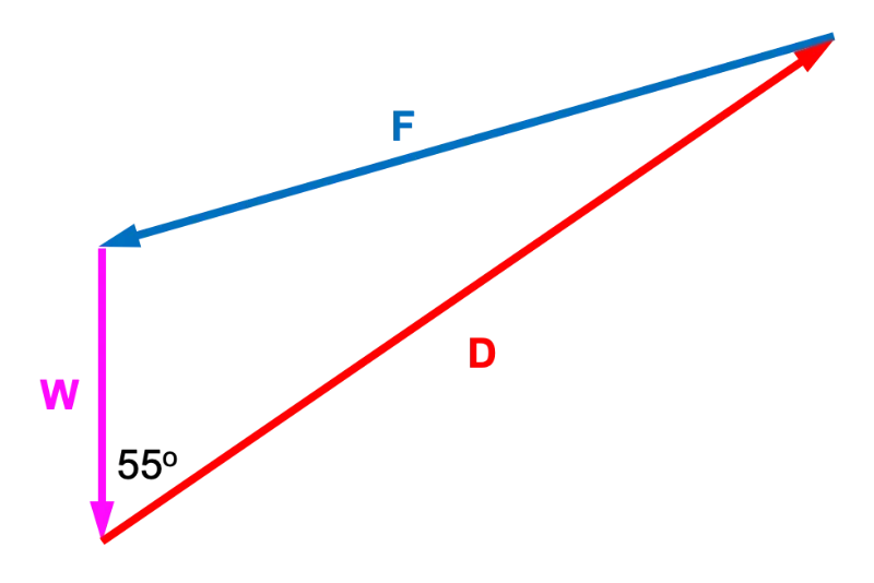

However, if we are allowed to move their point of application, the forces can be arranged to form a closed triangle because their vector sum is zero. The diagram on the right is the geometric solution to this question drawn to scale.
1773178859677.webp|D|,|F| > |W|. The weight gravity generates larger y force. F is downward, however 1773179826189.webpred force on screw is upward.”Only horizontal bar” model has something different from the original model. If D is parallel transport of the force the diagonal bar get from the wall, such a transport breaks the couple cancellation achieved in the original model.
anuttarasammyak said:
View attachment 370092|D|,|F| > |W|. The weight gravity generates larger y force. F is downward, however View attachment 370094red force on screw is upward.”Only horizontal bar” model has something different from the original model. If D is parallel transport of the force the diagonal bar get from the wall, such a transport breaks the couple cancellation achieved in the original model.

It seems you missed what post #13 shows.
I chose as system the horizontal bar only.
The physical situation says that the items exerting external forces on this system are
  1. The wall at the point of contact which could be a screw.
  2. The diagonal piece pushing from underneath up and to the right at an angle of 55o.
  3. The flower pot (assuming a massless horizontal bar) exerting its weight down at the point where the string is attached to the bar.
These external forces are represented as arrows in my post #13 diagram with force ##\mathbf F## resolved into its components.
Your drawing shows no diagonal piece and no diagonal force up and to the right. You can choose as system anything you like. However, if you remove an item from your system, and consider a reduced system, you must replace the item you removed with the force that it exerts on this reduced system. If you don't do this replacement, you have a different physical situation.

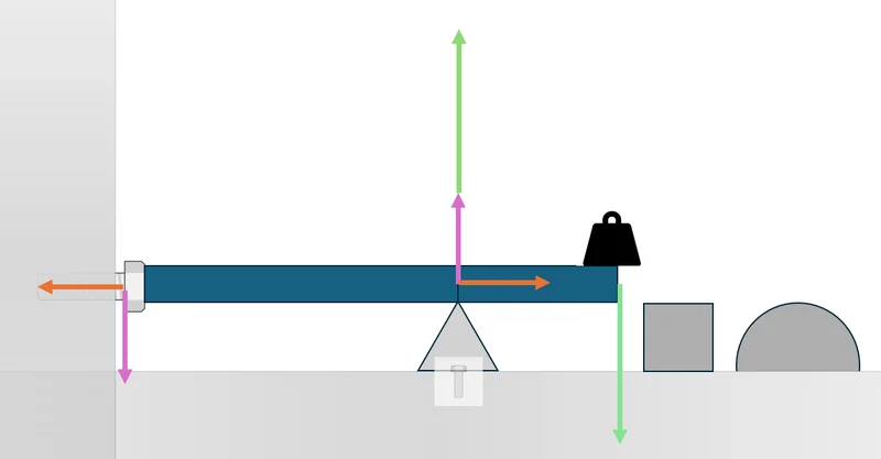

The blue length is important. The angle itself does not matter. Alternative orange rods are OK.
The diagonal rod tansmit not only force along it but also shearing force to the horizontal rod connected to it. In the original model it is an inner force of the rigid body which should be cancelled by another inner force so we do not have to go into the detail. We can concentrate on external forces.
If the diagonal rod has torque free hinges at both ends (as assumed by @kuruman) it doesn't transmit a shear force (perpendicular to itself), just an axial force (along itself).

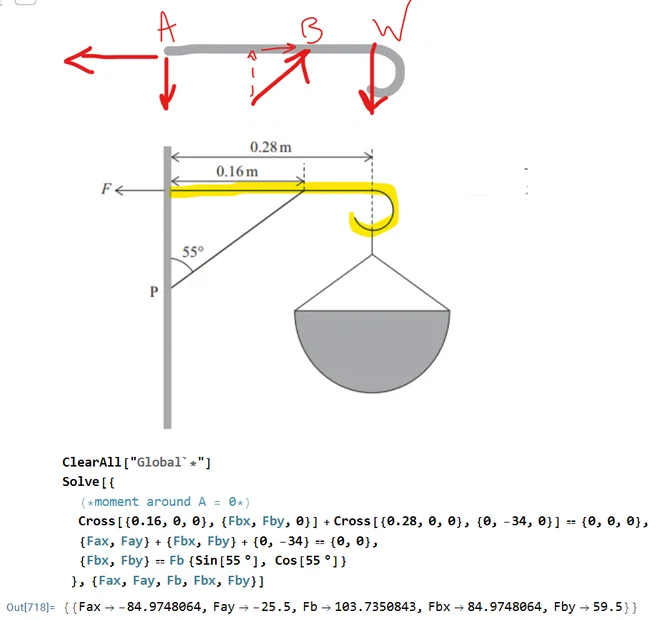

Drawing correct FBD's seems to be a common challenge. I think a lot of the online HW sets just draw all forces in positive direction by default, which is often wrong.
The symbols labeling the arrows in FBD represent magnitudes. One has to pick a direction for the tip of the arrow often without knowing beforehand if the direction is correct. This is necessary for writing down the equations and doing the algebra to get expressions for the unknown quantities. The expressions say it all. If the expression for the magnitude of a vector is negative, then its direction in the FBD must be flipped. This is not wrong because the goal of finding the magnitude and direction has been achieved.
For example, I found the components of the force that you cal A and I call F using the FBD on the right. Their expressions are $$F_x=W\left(\dfrac{L_2}{L_1}\right)\tan\theta~;~~F_y=W\left(1-\frac{L_2}{L_1}\right).$$ You are arguing that this FBD is incorrect because ##F_y## should be drawn "down". I am saying, "Who cares?" In post #40 I substituted the given numbers in the equations and got
##F_x= 84.97## N; the implied plus sign means "in the same direction as drawn in the FBD."
##F_y=-25.50## N; the minus sign means "in the opposite direction as drawn in the FBD."
Did I not get the same answers as you?
View attachment 370129For example, I found the components of the force that you cal A and I call F using the FBD on the right. Their expressions are $$F_x=W\left(\dfrac{L_2}{L_1}\right)\tan\theta~;~~F_y=W\left(1-\frac{L_2}{L_1}\right).$$ You are arguing that this FBD is incorrect because ##F_y## should be drawn "down". I am saying, "Who cares?" In post #40 I substituted the given numbers in the equations and got
