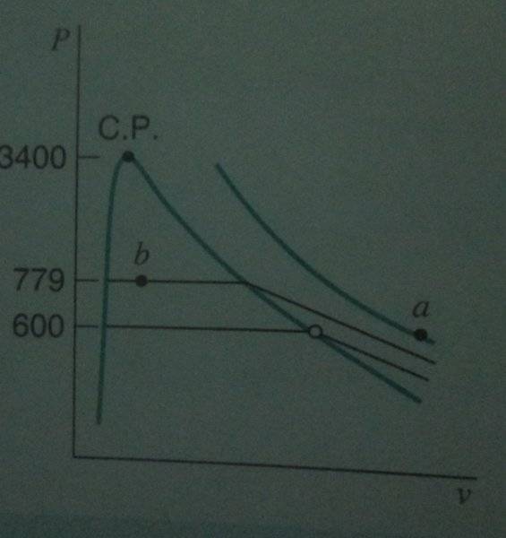

Hi. For a state of nitrogen in which temperature is higher than the critical temperature the state is presented on a different curve. I do not remember any curve for superheated region.
Source: Introduction to Engineering Thermodynamics by Sonntag/Borgnakke.
Thank you.

Is there a question here?
Yes, what is that curve which point a stands on?
Thank you.
Thank you.
It's an isotherm, for a temperature above the critical temperature.
