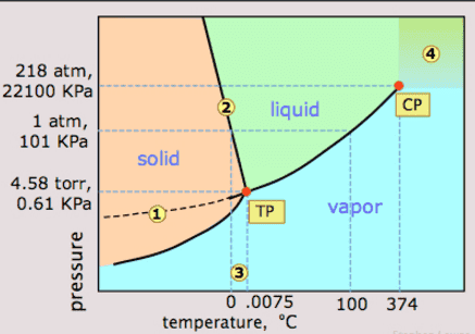

  • #34
I believe I understand, thanks to your help, the concepts you are mentioning: evaporation always occurs when the vapor pressure is less than the equilibrium vapor pressure and boiling when the equilibrium vapor pressure is larger than atmospheric pressure.
So, in the graph below, the coordinates P=1 atm and T=100 C indicate the boiling point (the normal boiling point since any other point sitting along that same line is also a boiling point) and that means the water vapor pressure P has to equal to 1 atm for boiling to occur, i.e. the vapor pressure on its own must be equal to the the same pressure that the entire mixture of gases composing air exerts on the free surface of the water and inside the liquid by pascal principle. It remains that the vertical axis is always and only the equilibrium, saturated, vapor pressure of water no matter if we are talking about the blue (vapor), orange(solid) or green(liquid) area in the diagram...

  • #37
The y-axis is the partial pressure of water vapor not the equilibrium vapor pressure.
Let's take the T = 100°C line for example. When the partial pressure of water vapor is less than 1 atm (i.e. PH2O < 1 atm), the gas phase is the thermodynamically favored phase and net evaporation of liquid into gas will occur. When PH2O > 1 atm, water is the thermodynamically favored phase and you will have net condensation of vapor into liquid. Only when PH2O = 1 atm can you have liquid and gaseous water coexisting at equilibrium. This is consistent with our observations in real life. If you leave a boiling pot of water on the stove (T = 100°C, PH2O ~ 8torr), the water will all eventually boil away. You could only get an equilibrium between the boiling liquid and vapor if you were to close the system to allow PH2O to build up to ~ 1 atm (this is what occurs in a pressure cooker).
The black line that defines the boundary between the vapor phase and the condensed phases (solid or liquid) defines the equilibrium vapor pressure of water at each temperature.
