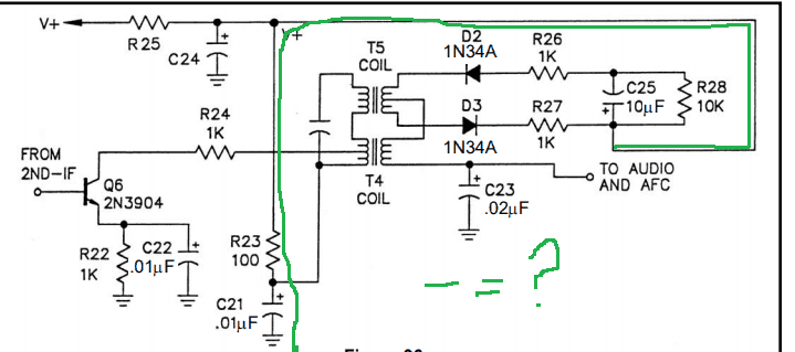

Ratio Detector connection question
Hi,
I built the attached ratio detector circuit and it works but I can't understand the reason for the connection marked in green.
I need an explanation, please.
Thanks in advance.
GR
What you have marked is not one path, it's two paths. The horizontal line along the top is the circuit's + supply. It is taken to one end of C25, and the detector modulates it to form the audio and AFC signal. The + supply is also taken to the primary of the multi-winding transformer to supply the collector current for Q26.
