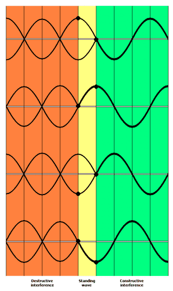

Imagine a closed box with reflecting walls. Inside you have two antennas emiting electromagnetic waves of certain wavelength. Both antennas are separated 1/4 of the wavelength (or some N wavelengths + 1/4) and one antenna is 90º phase-shifted (1/4 wavelength delayed) with respect to the other.
I attach a picture of the superposition we will get inside the box. We will get one side of destructive interference, one region between the antennas where a standing wave develops, and another side of constructive interference. You can see that the wall on the left is on the destructive interference region, so it almost doesn't receive any photons, but the wall on the right will receive a wave created by constructive interference:

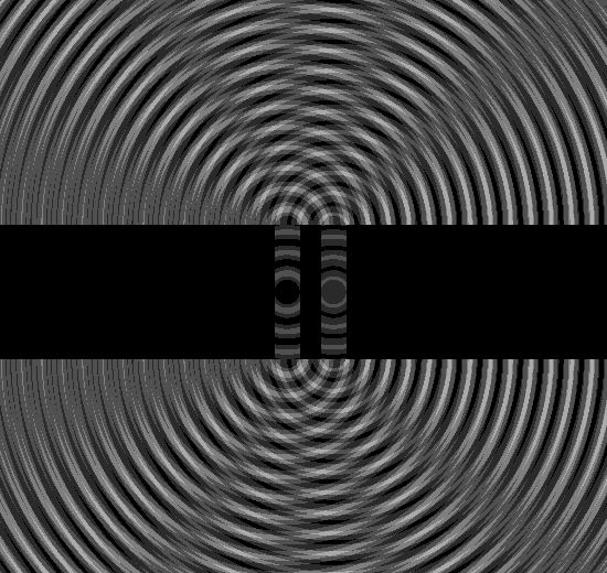

I also attach a top-view animation of the box and the different regions and waves that will develop. You can see there'll be more photons impacting the right wall:
So my question is: if we have more photons impacting one wall than the other, why shouldn't the box start moving to that direction?

The coloured diagram, which is of a wave in a 1D medium (eg a wave in a stretched wire) does not take account of the reduction in amplitude in proportion to the inverse square of the distance, that occurs with EM waves. Because it assumes no reduction, one of the antennas is always an exact offset and the other is an exact duplication of amplitude. That is incorrect.
I suspect that when the 3D nature of the waves is taken into account the difference in photon flux between two opposite walls will disappear.

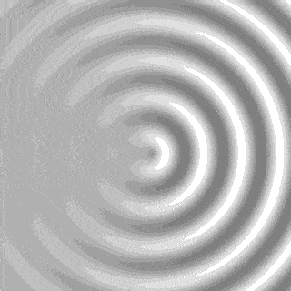

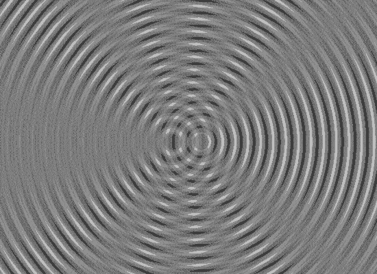

I made another animation separating the antennas, to show the different regions better.
You can see that the interference pattern changes a bit, and that the imbalance on both sides tends to disappear as the distance between the antennas gets bigger (the constructive and destructive interference regions begin to distribute more evenly on the available space).
So the antennas should be as close as possible (but keeping the wavelength ratios and delays to work properly).

I remade the animation in order to show a setup that keeps the antennas (or whatever method we use to create the waves or photons) outside the interference area. Now it looks more like the double slit experiment (where the interference area doesn't affect the emitter), but with two sources sending waves at the frequencies and distances we need to create the asymmetric distribution of the field.
It's as if we could change the position of the spot on the double slit experiment to left or right just by changing the delay between the two emitters:
Now, where would the reaction forces develop in this case?

Absolutely. That's the first lesson in two source interference.

@cala Those 'simulations' are what the standard analysis of two source interference will give you . I am not sure what your "pulsations" represent apart from the variation in time of the wave amplitude. Normally, this would not be included in the pattern plots as it just makes viewing difficult. Normally the radial scale would represent the RMS value of the wave amplitude in any particular direction. Those pictures are far more useful than the ripple tank - type pictures you started with.
